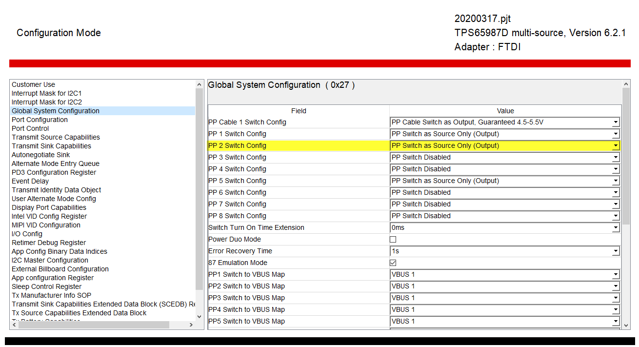

Would you please review the .pjt setting for Transmit sink path?
Is this go through internal path? how to tell the power switch path?
here is .pjt file.

Hello
The power path configuration is setup in register 0x27, Global System Configuration. Right now, both power paths are set up as source. Please use one of the default templates within the GUI as a starting point, and reference the power path connection from the EVM if you wish to operate both as a source and sink

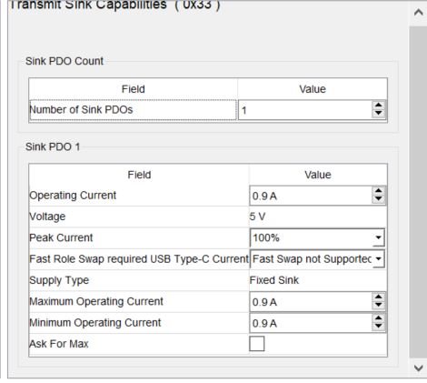

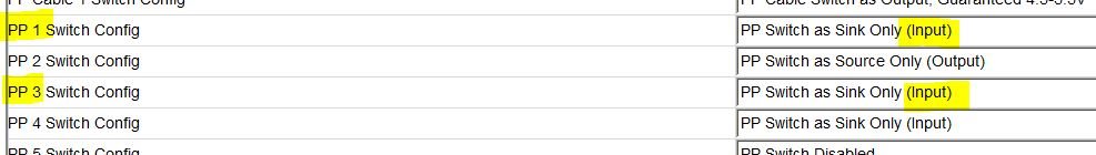

In the following case, would you please help for questions?
1. what are PP1 and PP3 differene?
2. in the attached GUI default example, what is the transmit sink power path? via PP1 or PP3? how to select?
BR,
SHH
PP3 is the optional external sink path. If you look on the TPS65987DEVM, there is the option to have an additional sink path through the external power path. PP3 configures this external power path.
