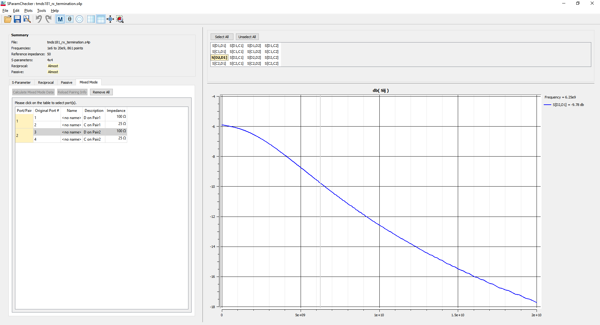

I'm trying to simulate the effects of the TMDS181 package on the HDMI transmission line.
I'm primarily interested in the receiver so I'm using the 'tmds181_rx_termination.s4p' file. Can you confirm the input/output port mapping as this isn't clear to me from either the guide or s-parameter comments.

  • Hi David,

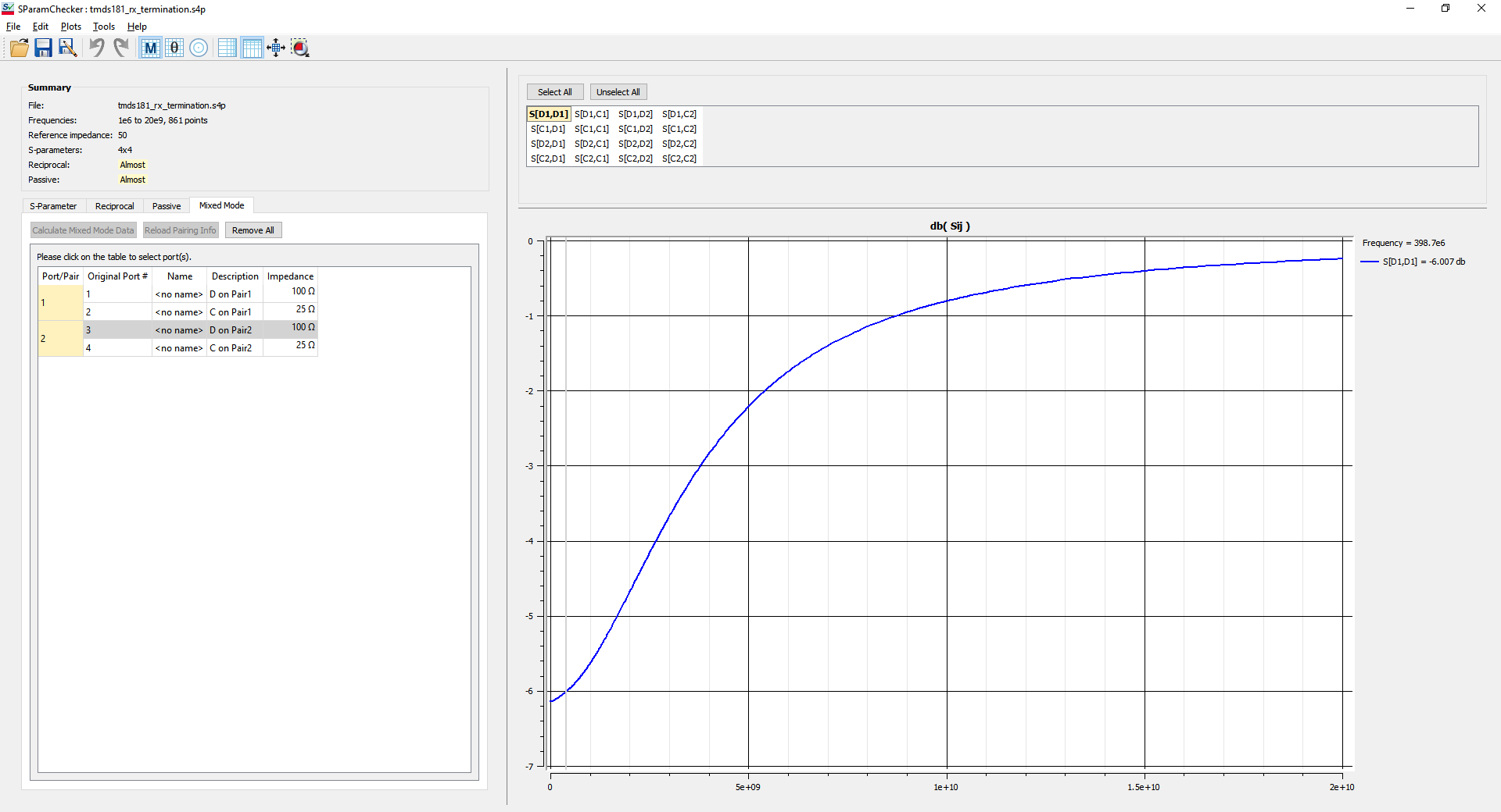

    I was getting some very strange results with the port mapping you suggested but looking at the workspace, it looks like 1/2 is input and 3/4 is output - hopefully I've interpreted this correctly.
    Upon viewing the s-parameter results using 1/2 as input and 3/4 as output I see a very poor return loss (-6dB @ near 0Hz) and the insertion loss doesn't appear to start from 0 which I've not seen before. I'm fairly new to interpreting s-parameters so it's quite possible that I've got the mixed-mode conversion wrong or am missing something but it would be great if you could clarify. I've attached images below.

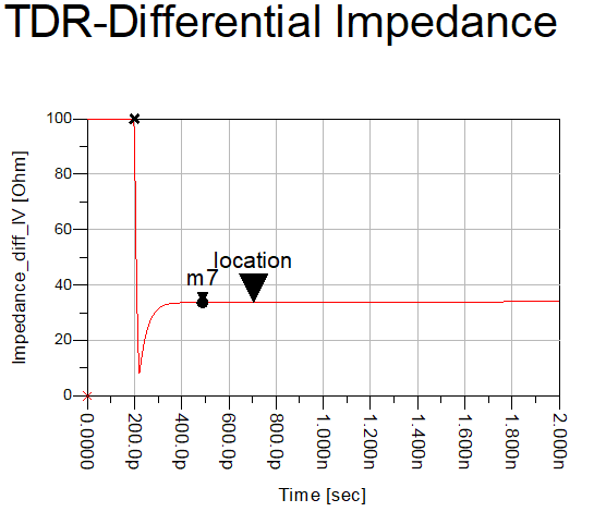

    Further to this, running a quick TDR test on the model - I see the following below. It seems to stray very far from the nominal 100Ohm impedance required. I assume I'm over-terminated somewhere but it would be great if you could advise. My schematic is essentially a TDR source connected directly to 1/2 of the tmds181_rx_termination.s4p model and then a 100R terminator across ports 3/4. There is nothing else in the circuit.

  • What are you trying to simulate? Are you trying to see if the TMDS181_rx_termination.s4p model has a 100ohm differential impedance?
    The model is intend to be used with other TMDS181 model components to mimic a complete TMDS181 retimer response, it is not intend to be used separately.
    David
  • Hi David,
    I need to simulate the effect the TMDS181 has on the impedance of a transmission line. I am trying to run a TDR test of the whole transmission line to do this but every time I include the TMDS181_rx_termination.s4p model the results look a little odd as if there's something wrong with the model.
    Can you advise how best to achieve what I'm trying to do? Do you have a model which represents the bond wire and any other loading the receiver might apply to the channel?
  • Unfortunately I don't have a model that represents just the package, the bond wire, and other loading of the TMDS181 RX. The  TMDS181_rx_termination.s4p model was never set up as a way to test the TDR of a transmission line.
    David
