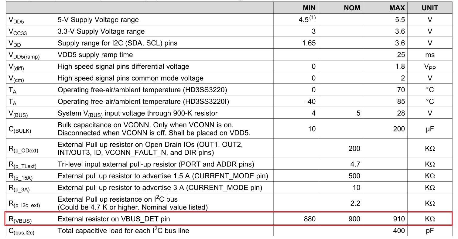

Hi Team,
The recommended resistor on VBUS_DET pin is 880kΩ~910kΩ, may I know if 910kΩ±5% or 820kΩ±5% can be used? If so, which one will be better?
The datasheet tells this pin is used to detect the connection with resistor divider, I think the resistor with different value can be sued in theory if the VBUS_DET pin is within its EC table.
Thanks and Best Regards!
