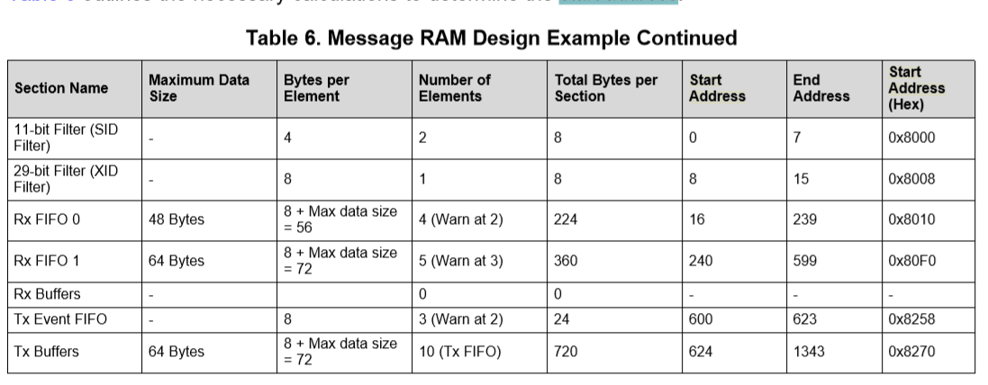

Dear SIr,
I know that start address of Tx buffer is 0x8270.
but Tx buffer start address is 0x8264 as below example.
please let me know witch start address is right? 0x8270 or 0x8264.

Hello Dexter,
I apologize for the confusion, but you have found a typo in our documentation. The correct address is 0x8270 and the offset address calculation in the example should be 0x8270 + (0x48 * 0x3) = 0x8348.
We have adjusted the source document and already submitted it for an official update. Once this is done, an corrected version will appear online.
Thank you for bringing this to our attention!
