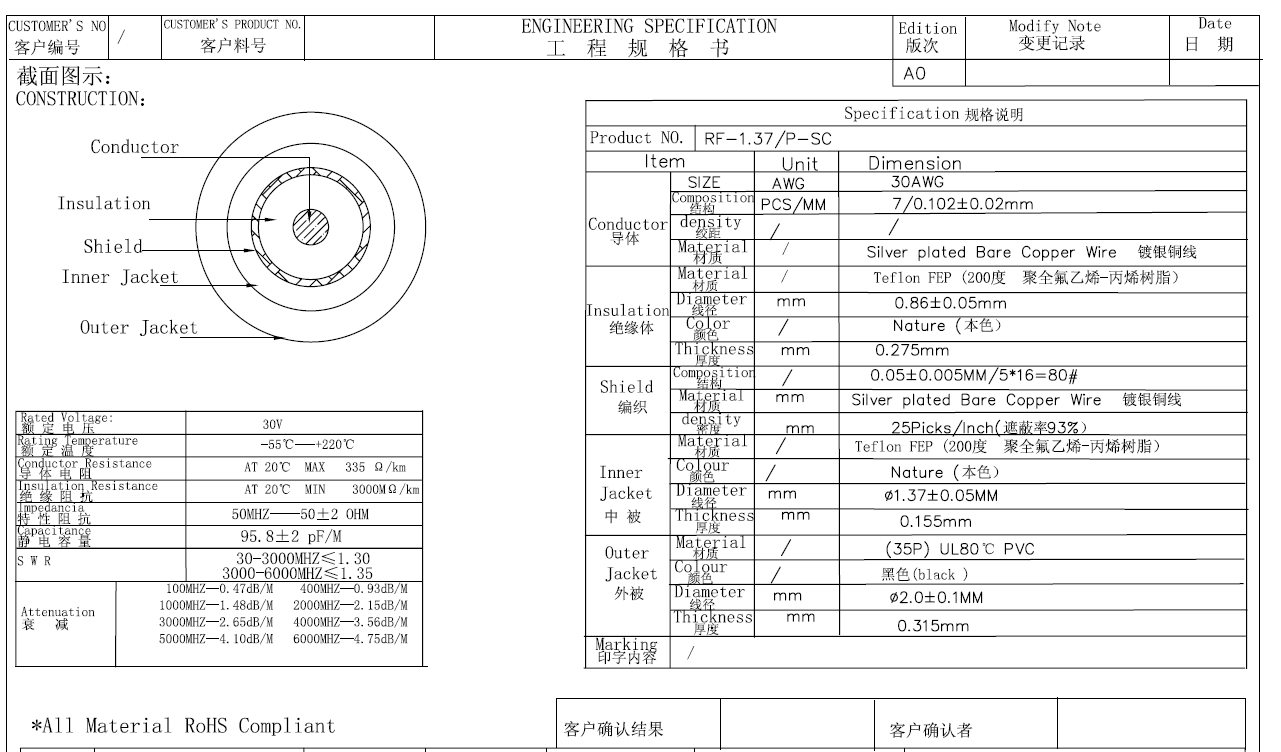

Hi
Here is my diagram: sensor - DS90UB953-Q1 - coaxial cable - DS90UB954-Q1(single-end), but for my test on recording on the road. It's easy appear with interference result video has purple frequency. The coaxial cable with 50 ohm and SMA connector. My question is how to avoid the interference with coaxial cable???
Please give me some tips. Thanks.
