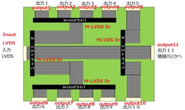

Can they configure for 11 M-LVDS outputs with 4 DS91M125s, like as the following figure?

Hi Muk-san,
The input of the DS91M125 is LVDS. It'd be better to use the SN65LVDS104 instead.

Hi I.K.-san,
The input of SN65LVDS104 is LVTTL. Can the SN65LVDS104 support M-LVDS input?
Do you have any other idea for the following configuration?
- Input is LVDS
- 11 outputs LVDS (same input signal: any LVDS)
Muk
Hi Muk-san,
Please check the datasheet again. The input for the SN65LVDS104 is LVDS, not LVTTL.
