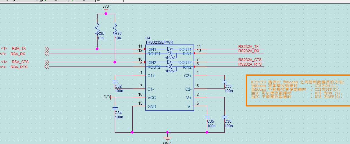

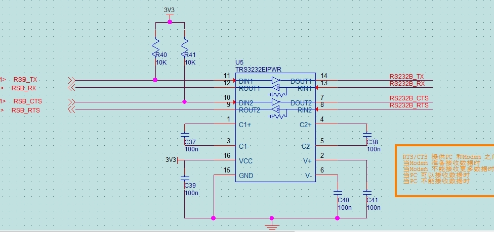

Dear team,
Please review customer schematic as below, customer connect RS232A_CTS  with RS232B_RTS,  they found when RSA_CTS high, but RSA_RTS is low, and RSB_RTS is low.
Customer test CTS independently, they found when RSA_CTS is low, RS232_CTS is not high, but table in datasheet display that RSA_CTS should be high.
Could you give some suggestion? Thanks.

  • Hi Sammi,
    The schematic you shared looks good. All pin numbers line up with what is specified on the datasheet, charge pump capacitors are sized and placed correctly, and supply voltage and pull-up values are good.
    I understand you are experiencing trouble with the device driver and you are not seeing the expected voltage on DOUT2 when DIN2 is toggled. Would it be possible to share scope shots of this driver channel input and output pins so we can see how each pin is behaving? Will you also check the voltages at the charge pump pins (primarily V+ and V-) to ensure that this part of the device is functioning correctly? If these pins are not holding +-5v respectively, please also share scope shots of the other charge pump pins (1, 3, 4, and 5).
    Eric

  • Hi Sammi,
    It appears the storage capacitors on V+ and V- (pin1 and pin6) are generating the correct voltage values. Seeing the scope shots of the input and output pin as well as the other charge pump pins will hopefully reveal more information to help us find a solution. Let me know when this information is available.

  • Hi Eric,
    Thanks for your reply. Customer measure the input and output pin,  when RSB_CTS=3.3V,RS232B_CTS=-5.01V;when RSB_CTS=0V,RS232B_CTS=-5.01V; seems that input changed but output has not changed. I am not sure if this helps.
    Thanks.
    Sammi
  • Hi Sammi,
    Since you are seeing a ~-5 V output we know the chip is properly powered and the charge pump is working.  For some reason it is just behaving as though the DIN port of interest is at a high level even when 0 V is measured.  Are you seeing this consistently across multiple PCBs/units?  Is it possible that this is simply a connection issue (e.g., bad solder joint)?
