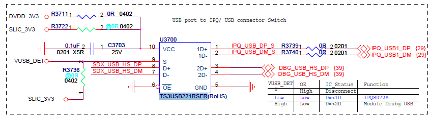

Dear team,
Customer design their system with TS3USB221 for USB mux, but now face to channel switch incorrect issue.
Channel cannot switch to 2D+/- when S pin go high status.
VBUS is resistor divider from USB_5V, S pin will go high as 3.35V when USB_5V plug in.
Please share your feedback with us. Thanks.
