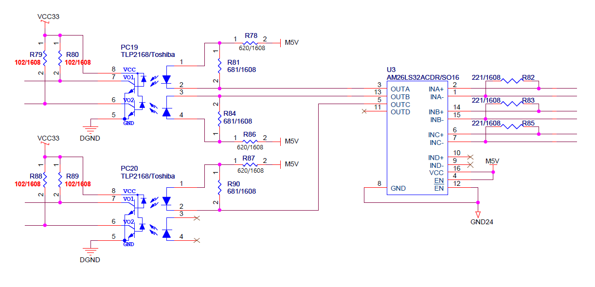

Hi Goowoon,
Thank you for sharing the schematic. It looks like the current requirements for TLP2168's LED are greater than the recommended output current for AM26C32. This current draw may be the cause of the temperature increase you are seeing. The schematic shows that this design includes AM26LS32AC which has a slightly higher output current, but is still below the 14mA Max rating specified by TLP2168. This specific device also has a slightly lower operating temperature range - an equivalent rating in the same family would be AM26LS32AI.
You mentioned you are also seeing elevated temperatures in the AM26C31 line drivers as well. Would you be able to share a schematic of one of these circuits? I don't believe the current draw described above would not apply to the drivers.
It is OK to leave unused RS-422 inputs/outputs and digital outputs floating. Digital inputs such as Enables and AM26C31's A pins should be tied to Vcc or ground. This appears fine in your schematic.
Eric

Hello Eric !
I think the current AM26C31 circuit part is not a big deal. However, I think there is still some problem with the AM26C32 circuit. The current of the photocoupler connected to the AM26C32 receiver is 6mA, but the temperature rises from 45 to 50 degrees. Do you think this is the normal operating range?
Please let me know if you have any further advice to improve or fix this problem.
Hi Goowoon,
Yes, as this temperature is below the recommended Max ambient temperature range, this temperature should not cause damage to the device. The device is designed to operate at this Max ambient temperature while still dissipating its own power, so the device temperature can increase past the specified ambient Max before damage will occur.
The cause of the heating is likely the large current draw from the digital output pins. This coupled with the device's quintessential current draw mean the device will likely have to dissipate over 100mW of power. With the relatively high thermal resistance of TSSOP package, this will translate to an increase of temperature around 10 to 20 C above ambient. This value is above what you may see in other applications because the device's digital outputs are typically not used to drive large current loads.
If you wish to reduce the device temperature, either less current needs to be drawn from the device pins or more thermal relief can be provided using a different package type (such as SIOC) or a heat sink. If the device is able to drive the photocoupler without other issue, AM26C32 will be fine to operate at this temperature. The result however would mean the system's operational ambient temperature may need to be closer to the transceiver's Maximum specified limit.
Let me know if this makes sense or if you have other concerns.
Eric
