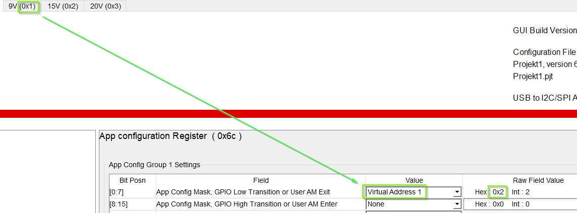

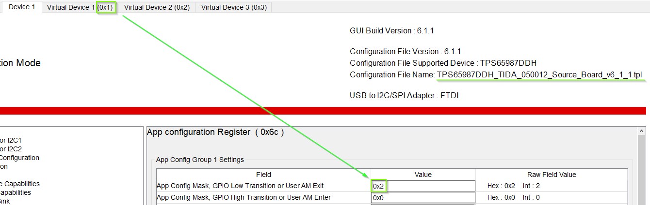

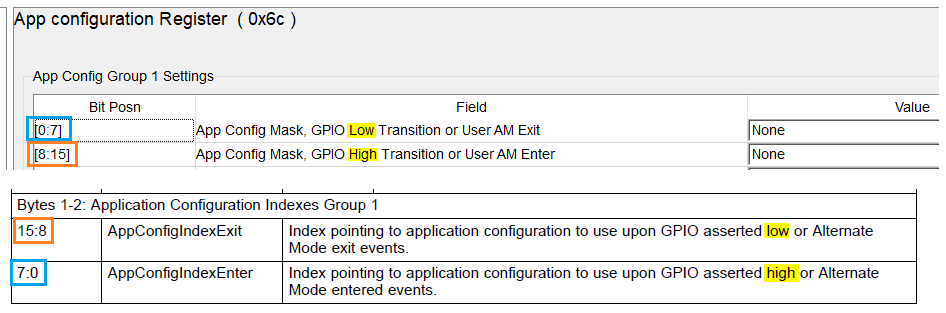

  • Hi Adam.
    I got my board and I was dealing with the GPIO configuration.
    I had some trouble because of some bugs with the Application Customization Tool (version 6.1.1). I will explain them here so others won't run into the same issues:
    1. The GPIO polarity shown by the GUI is wrong (see corresponding bitfields in datasheet)
    2. The mapping of the App Config Groups to the Virtual Devices is very strange if you use the TIDA50012 template as a start of your development. It is mandatory to know that Virtual Device 1 corresponds to the hex value 0x02, Virtual Device 2 to hex value 0x04, Virtual Device 3 to hex value 0x08, etc.
    3. If you start with a new template (Project - New Project - ...) this becomes a little more obvious. Because then a selection dropdown field appears.
