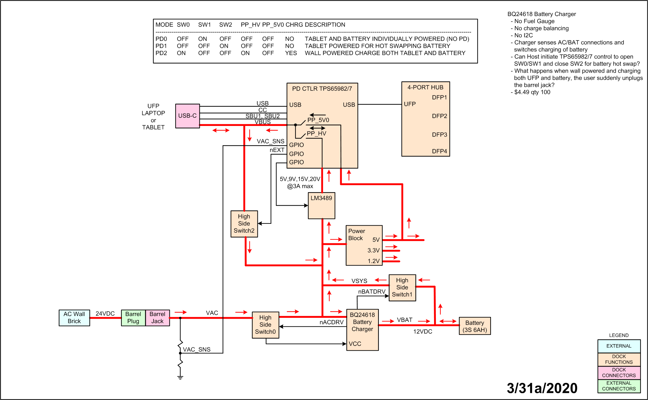

Tablet on UFP USB-C connector using TPS65982/7 for PD control.
Wall brick barrel connector and dock battery as power sources in addition to Tablet as UFP source.
Three power delivery modes
PD0. Tablet and Dock Individually Powered by their own batteries, i.e. no PD
PD1. Tablet Powered so that battery can be hot swapped
PD2. Wall Powered to charge both the tablet and the battery
Questions:
1. Control to the two switches that are used by the BQ24618 for adapter and battery appear to be mutually exclusive, and the device has a CE pin that can disable charging. Can the TPS6598x GPIO be used to turn off both BQ24618 switches to implement PD1 (Tablet Powered mode) described above?
2. Is there a bettter choice for a charging chip for this application?
