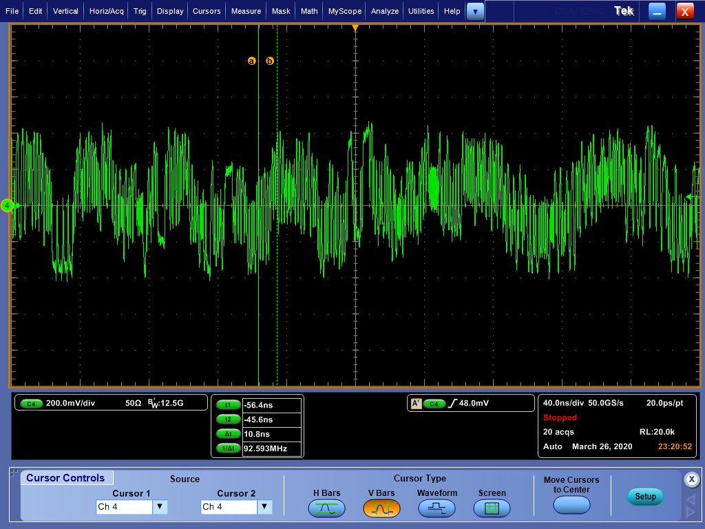

I'm trying to measure FPD-Link signal quality of DS90UB948-Q1. However,I got a FPD-Link signal from RIN0/1±  shown in picture below. It seem that it can not form one eye diagram or satisfy eye diagram test requirements.

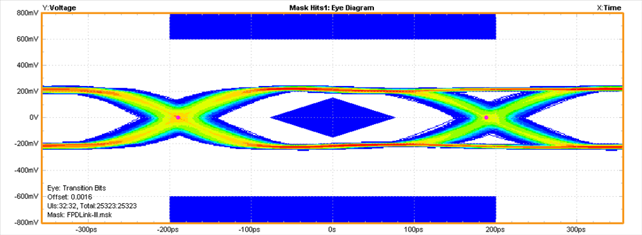

So I have caught a eye diagram from CMLOUT± shown below.
According to the datasheet, output signal on CMLOUT±  was recovered forward channel data from RIN±.
Then I wanna know if eye diagram on CMLOUT±  can stand for  FPD-Link signal quality totally? Or is the any other way to measure signal quality from RIN±  directly?
