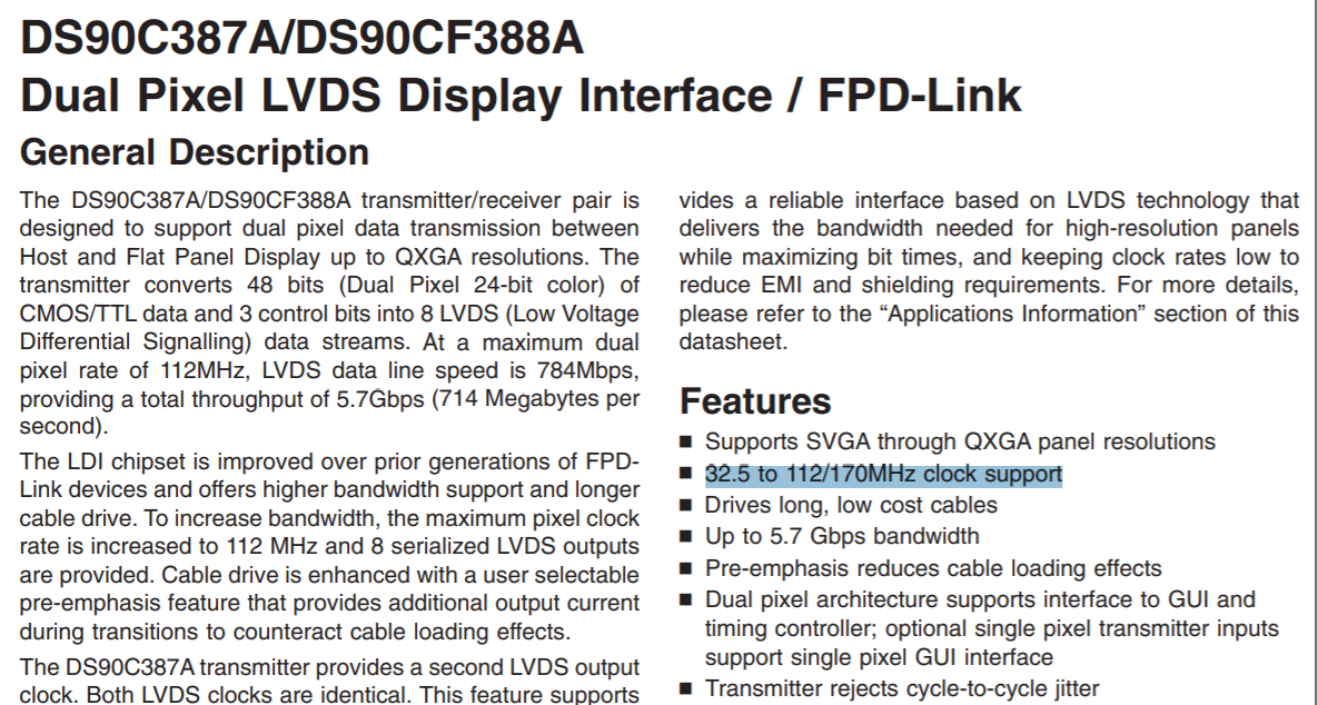

My customer use the signal RGB input, dual LVDS output mode. Under this mode, what is the max pixel rate?

For single to dual mode, the max pixel rate is 170MHz on the single side (85MHz per channel on the dual output side).
