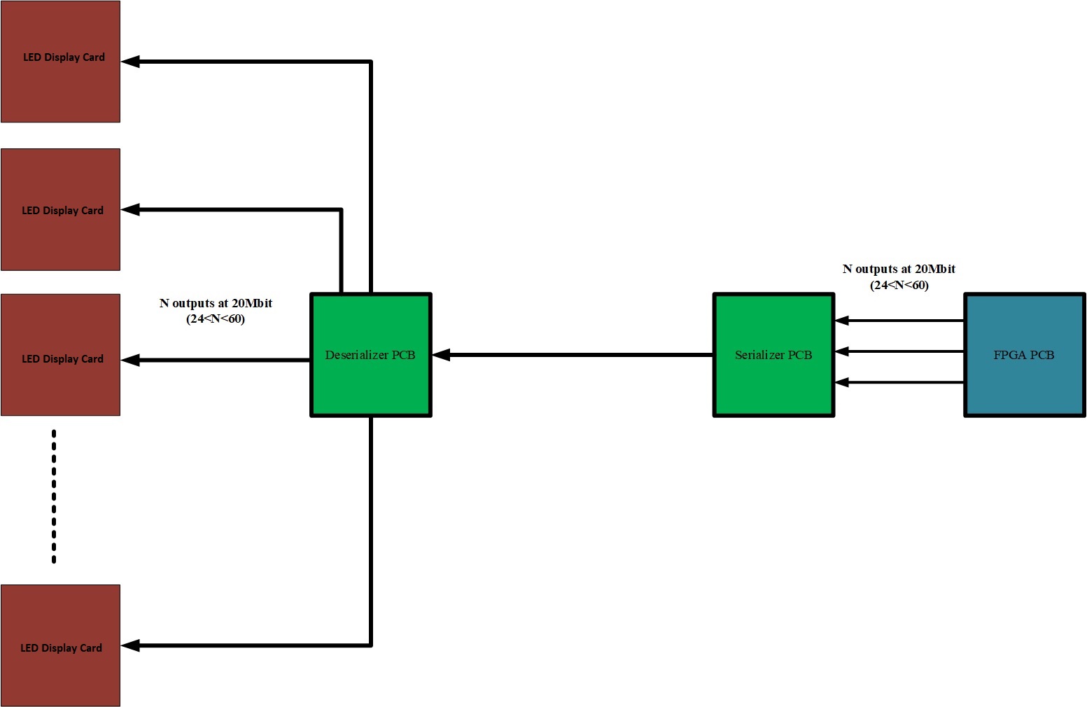

In my application I drive multiple led panels connected in series at one time. I am trying to find a solution for reducing the cable count between panels and fpga output(there is nearly 2 meter distance between).From the result of my browsing, I presume a ser/des pair or a serializer and a deserializer would be solution. While digging into the E2E forum I saw a lot of variety of ser/des ,flat link ser/des etc.. Which product or product group will  u recommend for my application?  And another question is, can I make a cascaded configuration with serializer/deserializer pairs. I have to reduce the cable count which is nearly 90 data line at the moment. I am trying to solve this problem in the least costly way. Please enlighten me on this topic.
I got 5 common signal :(Clock,Lathc,OE,Select1,Select2,Select3) and 15 flat panel group each has indivial 6 signal (R1,G1,B1,R2,G2,B2).
Clock will be operated at least 25 MHz.

  • Hi I.K.,
    Thanks for ur reply, I'm sharing the block diagram.
  • Hi Cem,
    To clarify, in your block diagram you would ideally like to have the deserializer supply the same output data to 15 LED panels simultaneously?
    Also, can you more clearly quantify the "N" outputs from the FPGA? 24 to 60 is a big range.
    I.K.
  • Hi I.K.,
    Yea, I expect the same data output from the deserializer output to 15 LED panels simultaneously.
    I am giving the N value in range because of in my application LED panel count can vary. I would be glad if you could guide me for 32 outputs. Thanks for your effort.
  • Hi Cem,
    Sorry for the delay and thanks for the clarification. This will be a bit difficult and rather complicated to implement with what we have.
    One idea:
    Serializer: DS92LV3221: This Channel Link II serializer will serialize up to 32 parallel inputs to two serial LVDS outputs (data split between the channels) with embedded clock.
    Repeater: DS10BR254. 1:4 LVDS repeater. You would need to cascade multiple of these to get to 15 panels while also accounting for the 2 LVDS outputs from the DS92LV3221.
    Deserializer: DS92LV3222. This is the companion deserializer to the DS92LV3221 serializer. Each panel would require one.
    I.K.
  • Another option:
    Serializer: DS92LV16. You could use 2 of these serialize 32 bits
    Repeater: SN65LVDS116. This is a 16 channel repeater (data rates up to 400 Mbps) so you would just need one
    Deserializer: DS92LV16. 2 of these on each panel for 32 bits
