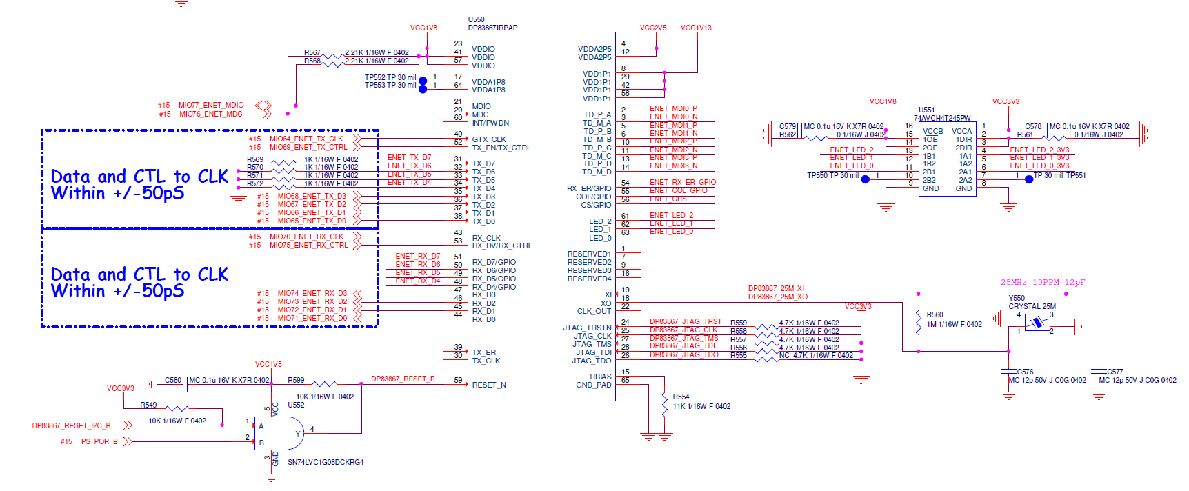

Part Number: DP83867IR
Dear Team,
Can you help with double-checking the schematic?
Please let me know if any concerns.
Appreciated!

Hello Kevin,
Have you consulted the schematic checklist? Do inbox me if you need any help. At first look, only thing that looks missing is the decap on each supply (as per datasheet). But I strongly recommend you to go through the checklist once.
