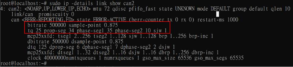

We are looking for BTR(Bit Timing Register) setting of TCAN1043-Q1 in below table but lack of “Sample mode” information.
Could you please help on it?
Thank you
BTR Parameter
Value
Number of Tq
25
Tseg1 (prop_seg + phase_seg1)
69
Tseg2 (phase_seg2)
10
Sample point (%)
0.875
Synchronisation Jump Width (SJW)
1
Sample mode (single or 2 out of 3)
Baud Rate Prescaler (BRP)
 1

    Sample mode is the way in which the controller samples each bit: single sample or majority mode. In single sample mode, the bit is sampled once at the sample point and that logic value is accepted as the value by the controller. In majority mode, the CAN bus signal passes a digital low-pass filter, using three samples and majority logic to determine the bit value. The majority mode adds additional delay of 1 time quanta resulting in a longer Prop_seg.

  • Hi Eric,
    Thanks for feedback. Can I say the sample mode selection should be control by SW?
    If yes, can I read the sample mode setting from Host-MCU? Or any method to get this information?
    Thank you
  • Anne,
    Yes, the sample mode is in the CAN controller configuration code, based on the customer's application. Is the customer requesting this information?
