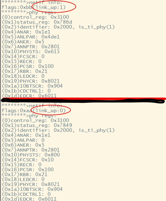

When DP83848Q is connected to the router, sometimes the LED blinks blinks frequently at the beginning, then finally the LED will turn on which shows the connection is good. After changing the cable or router, the LED will not blink at the beginning.
There is also another weird problem, DP83848Q doesn't blink when large data is transmitted. Could you please help advise the possible reasons for the LED blinking?
Here is the register value before and after LED turning on.
Thanks and Best Regards!
