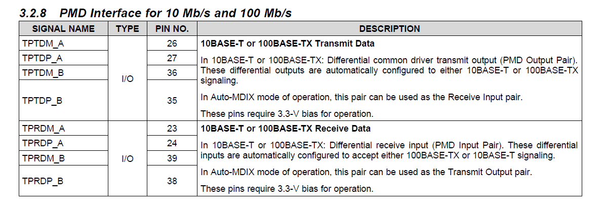

We are interested in what type of ESD or other transient OV protection do the output PMD pins for this IC have. Are there diode clamps to power rails?
Pins of interest: 23,24,26,27 and  35.36,38,39:
Thank you!

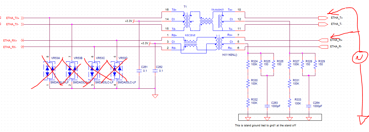

    Thank you for your reply. In our application we are required to survive a lightning transients into the output of the Ethernet transformer.  The standard test is to inject the lighting pulse directly into one of the pins (Tx- and TX+  or RX- or RX+ are not tied together).  Even though there's galvanic isolation, there's still concern that fast DV/DT pulse will couple to the primary side and reach the PHY even though highly attenuated.
    Before considering putting protection on the primary side (see attached) and doing much more detail analysis of the parasitics in the transformer,  I'd like to understand what kind of protection does the PHY itself has against OV transients like ESD.  Our early tests with external protection, high speed, low capacitance TVS array distorted the waveform out of compliance with IEEE spec.  So we are looking for other options.

  • I can describe approximately:
    Differential transient voltage at the pins of the PHI (TX+, Tx- and RX+, RX- as listed in previous reply) into 100 ohm load (with PHY removed) can reach  ~234V  for about 200 nanoseconds.
    with peak current ~3-4 amps for 200ns.
    Common mode voltage froe pins of the PHI (TX+, Tx- and RX+, RX- as listed in previous reply) to the common ground:  140V, 2.5A peak for ~150ns
    For energy calculation, wave shape can be assumed square pulse.
    Numbers above are extrapolated from actual lighting event levels, there's some uncertainty.
    We are allowed to have data drop during lighting event as long as recovery happen.
    Thank you for looking into that.  Any information on clamping would be helpful.

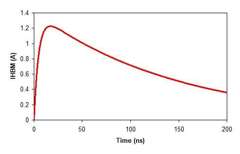

  • Hi Vitaliy,
    I was trying to see how close it is to the ESD kind of event which our ESD structures can take care without damaging the phy. But these mentioned voltage/current peaks and durations are much higher.
    Here are the ESD like events that we have tested and I see that duration of current is much higher in your test.
    Vikram
