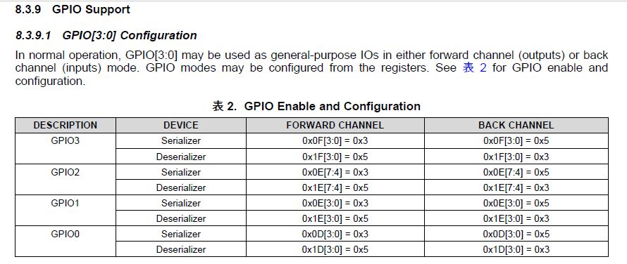

Now i have a problem,i set GPIO_2 and GPIO_3 of the DS90UB948 to high level,but the status of the GPIOs can not transmitt to GPIO_2 and GPIO_3 of the DS90UB948.
is there a standard setting of the gpios regsters?

Are you trying to set the GPIOx of the 948 through 941AS from the serializer side? Please confirm.

Could you please confirm if you are planning to use GPIO2 (pin 38) and GPIO3 (pin 39) or D_GPIO2 (pin 44) and D_GIO3 (pin43) of the 941AS? I also need if you can provide me the register dump.

Just checking back with you if you need further assistance. Configuring the GPIOs should be very straight forward. For example, if you want to route the GPIO3 from 941AS to 948 forward channel, you need to configure the 941AS serializer as input register 0x0F = 0x3 and 948 deserializer to ox1F = 0x5. Now, if you apply a voltage let say 1.8V to GPIO3, you should be able to see the output from the other side of the 948.
