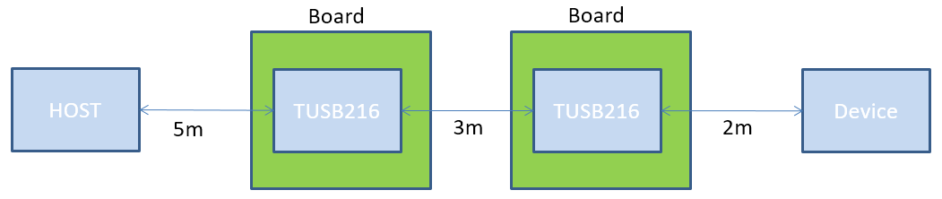

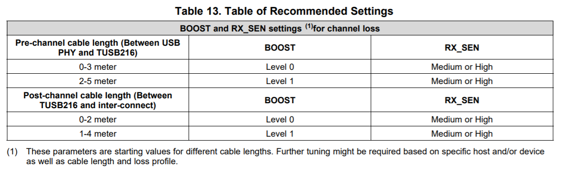

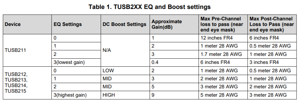

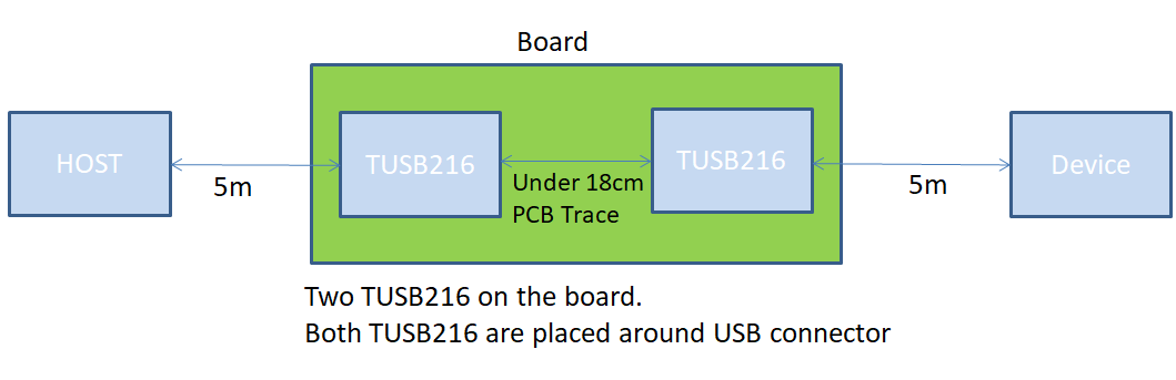

According to the application note, TUSB212 can be 5m for pre-channel(Host) and 3m for Post channel(Device ) with EQ and Boost.
I'd like to use 3m for host side and 5m for device side. Is it possible?
If D1 and D2 are swapped, is there no point because of "6.2 Can D1 and D2 be swapped?" ?
