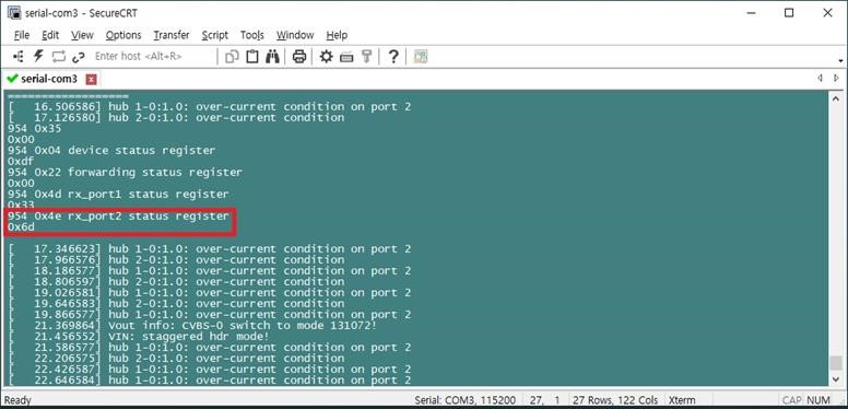

DS90UB954-Q1: ub954, 0x4E (RX_PORT_STATUS2) error of 0x6D.
Part Number: DS90UB954-Q1
Dear Sir,
My customer is debugging DS90UB954-Q1.
When read 0x4E register After Initialization. the value is 0x6D
Could you advise me debugging point?
    What is the MODE strap setting for 954 and what serializer device is connected to the port?
    Casey

  • Hi Dexter,
    Can you please try reading this particular register twice, read it, wait about 5-10 seconds, then read it again. This is because there's multiple bits in there that are Clear on Read (COR) and can be set during initialization but are not real faults. Let's first ensure that these are actual errors.

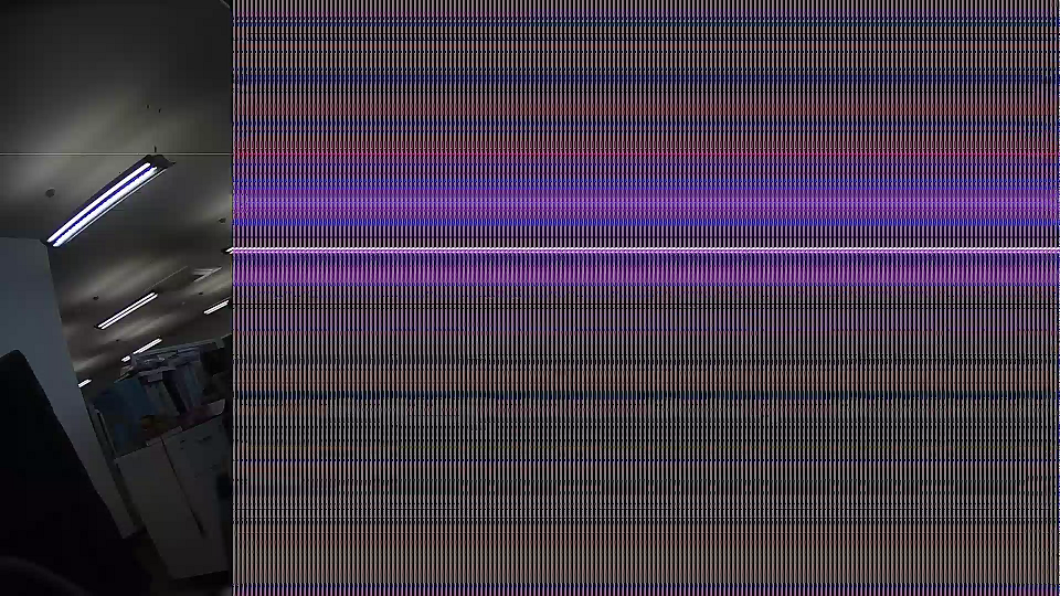

  • Hi Mandeep,
    could you help as below situation. please let me know any advise to me.
    1. actual image is abnormal as attached capture.
    2. When the Status register is read twice, it is displayed as shown below.
    # i2cget -y 0 0x30 0x4d bb
    0x3b
    0x03
    # i2cget -y 0 0x30 0x7a bb
    0x0f
    0x0c
    3. The image sensor output is set to 1920x1080. However, if you read the 0x73 ~ 0x76 register, it is strange. The number of lines is normally read as 1080, but it is strange that the line length is read as 2880.
    # i2cget -y 0 0x30 0x73 bb
    0x04
    # i2cget -y 0 0x30 0x74 bb
    0x38
    # i2cget -y 0 0x30 0x75 bb
    0x0b
    # i2cget -y 0 0x30 0x76 bb
    0x40
  • Hi Dexter,
    Please see my comments below
    0x4D = 0x03 #looks good, you have lock
    0x7a = 0x0c #You are getting length and checksum errors. This can be because the imager is not transmitting CSI data correctly or the data is getting corrupted during the transmission.
    0x73, 0x74 = 0x04, 0x38 # Hex to decimal = 1080 (as expected)
    0x75, 0x76 = 0x0b, 0x40 # Hex to decimal = 2880, the register reads as 8-bit, but you are transmitting data as 12 bit, therefore you have to do a conversion. (2880*8)/12 = 1920 (as expected)
    The main issue I'm seeing is that you are getting CSI errors. Can you try the following steps.
    1) Turn on PatGen on the 954 and capture the results.
    2) If results are good, then proceed to turn off PatGen on the 954 and Turn on Patgen on the 953 and capture/share the results.
    Mandeep Singh

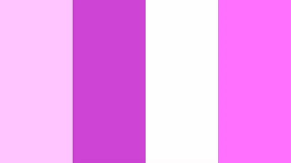

  • Hi Mandeep Singh,
    Could you please check PatGen Image for 954 and 953. looks like the PatGen image is abnormal.
    can you advise me any comment for the PatGen images.
    1. 954 PatGen Enable
    2. Register setting
    i2cset -y 0 0x30 0xB0 0x00 bb
    i2cset -y 0 0x30 0xB1 0x01 bb
    i2cset -y 0 0x30 0xB2 0x01 bb
    i2cset -y 0 0x30 0xB1 0x02 bb
    i2cset -y 0 0x30 0xB2 0x33 bb
    i2cset -y 0 0x30 0xB1 0x03 bb
    i2cset -y 0 0x30 0xB2 0x24 bb
    i2cset -y 0 0x30 0xB1 0x04 bb
    i2cset -y 0 0x30 0xB2 0x16 bb
    i2cset -y 0 0x30 0xB1 0x05 bb
    i2cset -y 0 0x30 0xB2 0x80 bb
    i2cset -y 0 0x30 0xB1 0x06 bb
    i2cset -y 0 0x30 0xB2 0x02 bb
    i2cset -y 0 0x30 0xB1 0x07 bb
    i2cset -y 0 0x30 0xB2 0xD0 bb
    i2cset -y 0 0x30 0xB1 0x08 bb
    i2cset -y 0 0x30 0xB2 0x04 bb
    i2cset -y 0 0x30 0xB1 0x09 bb
    i2cset -y 0 0x30 0xB2 0x38 bb
    i2cset -y 0 0x30 0xB1 0x0A bb
    i2cset -y 0 0x30 0xB1 0x0B bb
    i2cset -y 0 0x30 0xB2 0x65 bb
    i2cset -y 0 0x30 0xB1 0x0C bb
    i2cset -y 0 0x30 0xB2 0x0B bb
    i2cset -y 0 0x30 0xB1 0x0D bb
    i2cset -y 0 0x30 0xB2 0x93 bb
    i2cset -y 0 0x30 0xB1 0x0E bb
    i2cset -y 0 0x30 0xB2 0x21 bb
    i2cset -y 0 0x30 0xB1 0x0F bb
    i2cset -y 0 0x30 0xB2 0x0A bb
    954 PatGen Image Capture

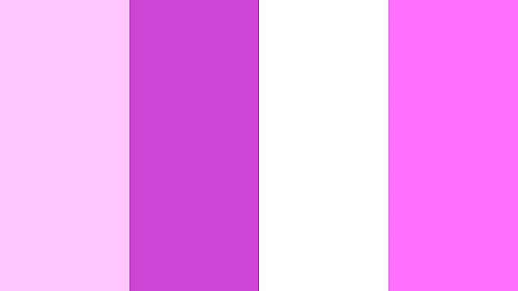

    1. 953 PatGen Enable
    2. Register setting
    i2cset -y 0 0x0c 0xB0 0x00 bb
    i2cset -y 0 0x0c 0xB1 0x01 bb
    i2cset -y 0 0x0c 0xB2 0x01 bb
    i2cset -y 0 0x0c 0xB1 0x02 bb
    i2cset -y 0 0x0c 0xB2 0x33 bb
    i2cset -y 0 0x0c 0xB1 0x03 bb
    i2cset -y 0 0x0c 0xB2 0x24 bb
    i2cset -y 0 0x0c 0xB1 0x04 bb
    i2cset -y 0 0x0c 0xB2 0x16 bb
    i2cset -y 0 0x0c 0xB1 0x05 bb
    i2cset -y 0 0x0c 0xB2 0x80 bb
    i2cset -y 0 0x0c 0xB1 0x06 bb
    i2cset -y 0 0x0c 0xB2 0x02 bb
    i2cset -y 0 0x0c 0xB1 0x07 bb
    i2cset -y 0 0x0c 0xB2 0xD0 bb
    i2cset -y 0 0x0c 0xB1 0x08 bb
    i2cset -y 0 0x0c 0xB2 0x04 bb
    i2cset -y 0 0x0c 0xB1 0x09 bb
    i2cset -y 0 0x0c 0xB2 0x38 bb
    i2cset -y 0 0x0c 0xB1 0x0A bb
    i2cset -y 0 0x0c 0xB1 0x0B bb
    i2cset -y 0 0x0c 0xB2 0x65 bb
    i2cset -y 0 0x0c 0xB1 0x0C bb
    i2cset -y 0 0x0c 0xB2 0x0B bb
    i2cset -y 0 0x0c 0xB1 0x0D bb
    i2cset -y 0 0x0c 0xB2 0x93 bb
    i2cset -y 0 0x0c 0xB1 0x0E bb
    i2cset -y 0 0x0c 0xB2 0x21 bb
    i2cset -y 0 0x0c 0xB1 0x0F bb
    i2cset -y 0 0x0c 0xB2 0x0A bb
    953 PatGen Image Capture
  • Hi Dexter,
    The captures are typically black and white, is the pink color because of the processor? Perhaps it's not translating the color to black and white. Looking at this quantitatively between the ser and the des, the captures look similar and normal. In comparison to your capture, we are no longer seeing a disrupted capture like what you were capturing earlier from the imager. This could mean a few things listed below.
    1)The imager is outputting corrupted data which is what we're seeing at the processor.
    a) Have you captured the CSI data directly from the imager without the serdes?
    2) This could be an issue with the processor not being able to capture all the data.
    a) What is the resolution (hactive, Vactive, Hblank, Vblank), fps, data type of the imager?
    Mandeep Singh
