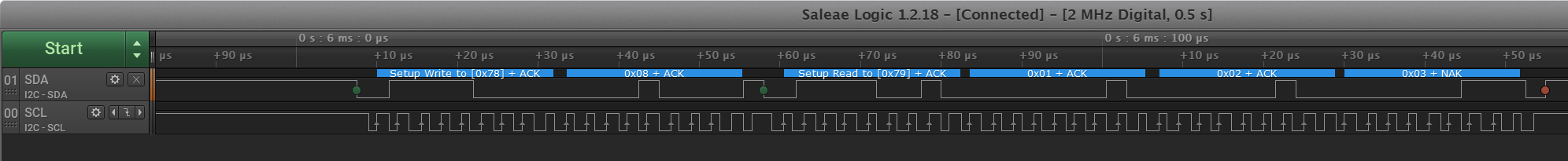

I would like to know if DS90UH948's I2C interface has register address auto-increment function or not?
I currently specify each register address every time, but I would like to eliminate the I2C bus traffic and
just send initial register address and data, then send the data only for the following registers.
For example : 1E, 1F = address, 11, 01 = data
1E 11
1F 01
--> 1E 11 01
