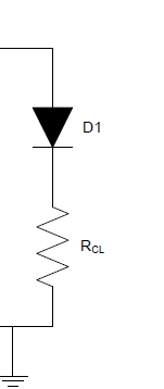

The LED_1 output is not driving HI for SPEED indication.
Trying to implement CRS strap mode 2.

Just to be clear, the current strap configuration is correct?
Strap options alone will not configure the LED_1 active HI, programming is required?
Steve
Hi Steve,
The strap resistor values and topologies look correct. Just to make sure that there is no other problem with strap latching/mode of phy, I asked you to configure the LED_1 through software also and see if LED glows this time.
