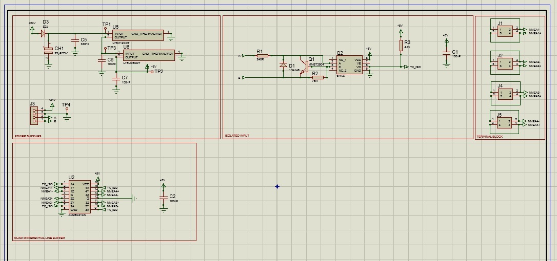

  • Hi Max,
    Please find below my design. Now, I'm just thiking about how to isolated the four outputs.
    Fabrice
  • Hi Fabrice,
    The AM26C31 implementation looks good to me, although it would be a general best practice to pull unused digital input (like the G pin) high or low so that they are in a defined state.  You may want to the 6N137's vendor to review that implementation since they will have better expertise on it.
    Regarding isolation, this is typically done on the digital signals (TX_ISO in this case).  It would be more difficult to isolate the differential lines directly.  Since you already have the opto-coupler on for TX_ISO, though, why is additional isolation needed?
    Max

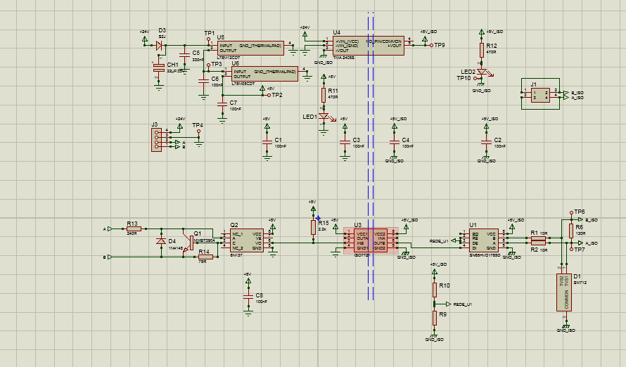

  • Hi Max,
    Thank you for your answer, it was I was thinking.
    I have made a new design (only with one output for the moment, I just need to multiplicate this one 3 times).
    I've kept my isolated input by optocoupler. The input current of ISO7721D on INx is only 10µA (so I can connect four ISO7721D to the output of my optocoupler). On my side, I've the habit to use the SN65HVD1785, I think it's an equivalent of THVD2450.
    I'll have four DC/DC converter, it'll cost a little bit more, but il'll be more safe for me.
    I've only connected the OUTx of the ISO7721D because NMEA signal in only going in one way, for REDE, I'll connect it to ground.
    But I'll think about using an optocoupler to do that, it'll be cheaper I think.
    Thank you,
    Fabrice
  • Fabrice,
    Thanks for posting, I agree this design should be pretty robust.  I'm wondering why you would use both the opto-coupler and the digital isolator, though - could you not just directly connect your digital input to the ISO7721 input (rather than to the optocoupler)?
    Max
