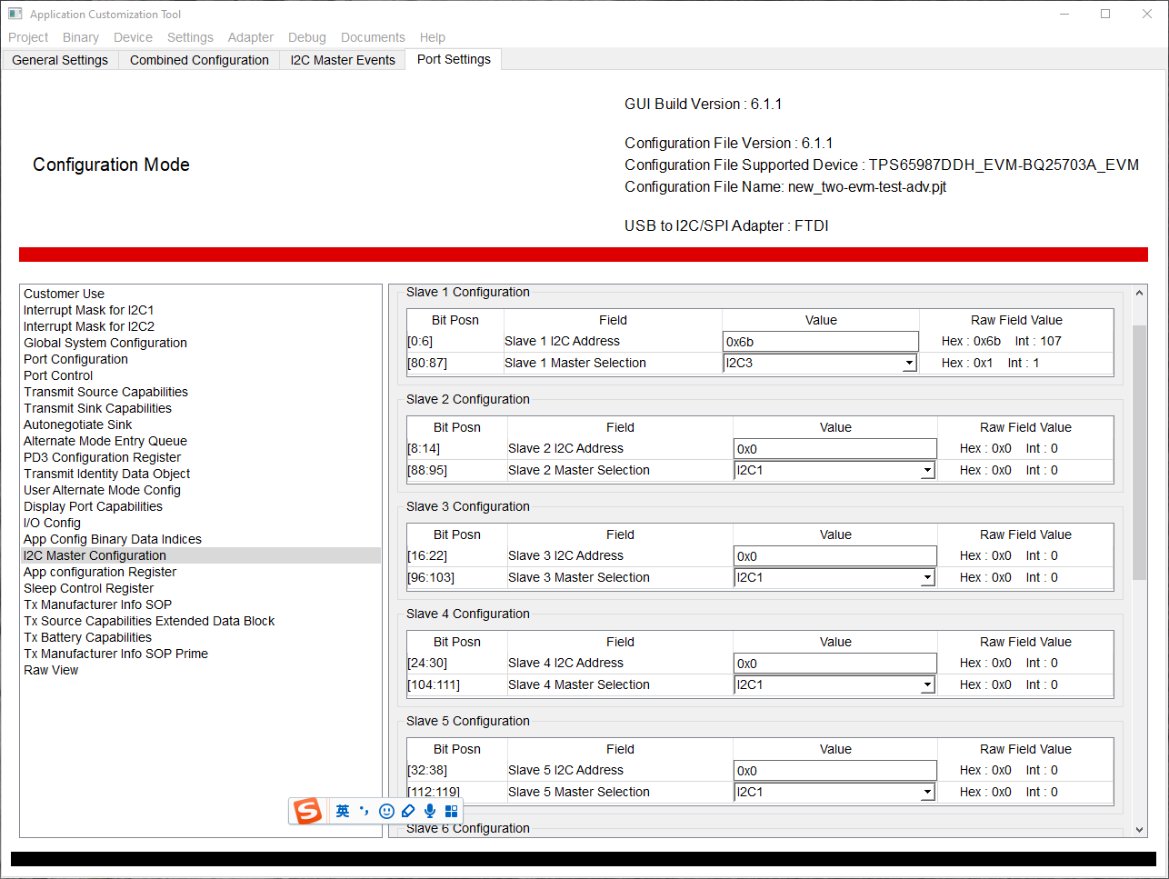

When I configured the TPS65987D I2C Master, the GUI shows that Slave 1 configuration bit position and register length are different than SLVUBH2B (TPS65987DDH and TPS65988DH Host Interface
Technical Reference Manual) writting. In SLVUBH2B P90 3.43, it has SlaveEnable field and SlaveAddr is at 7:1 of byte1 but the GUI indicate address is 0:6; And the length of register is 20 in GUI but 16 in SLVUBH2B.

    Thanks for sharing this discrepancy, will share this with our GUI expert. For the mean time, recommend populating the fields as shown in the GUI, even if they don't exactly line up with the technical reference manual.
    Attached is the project file used for the Power Bank reference design. You can import these settings into your project to use as a reference. You will need to open an existing project, and then click Project -> Import settings from project.
    4645.88DH Power Bank.pjt
    As far as the addressing, yes 0x6b should be the correct address to use

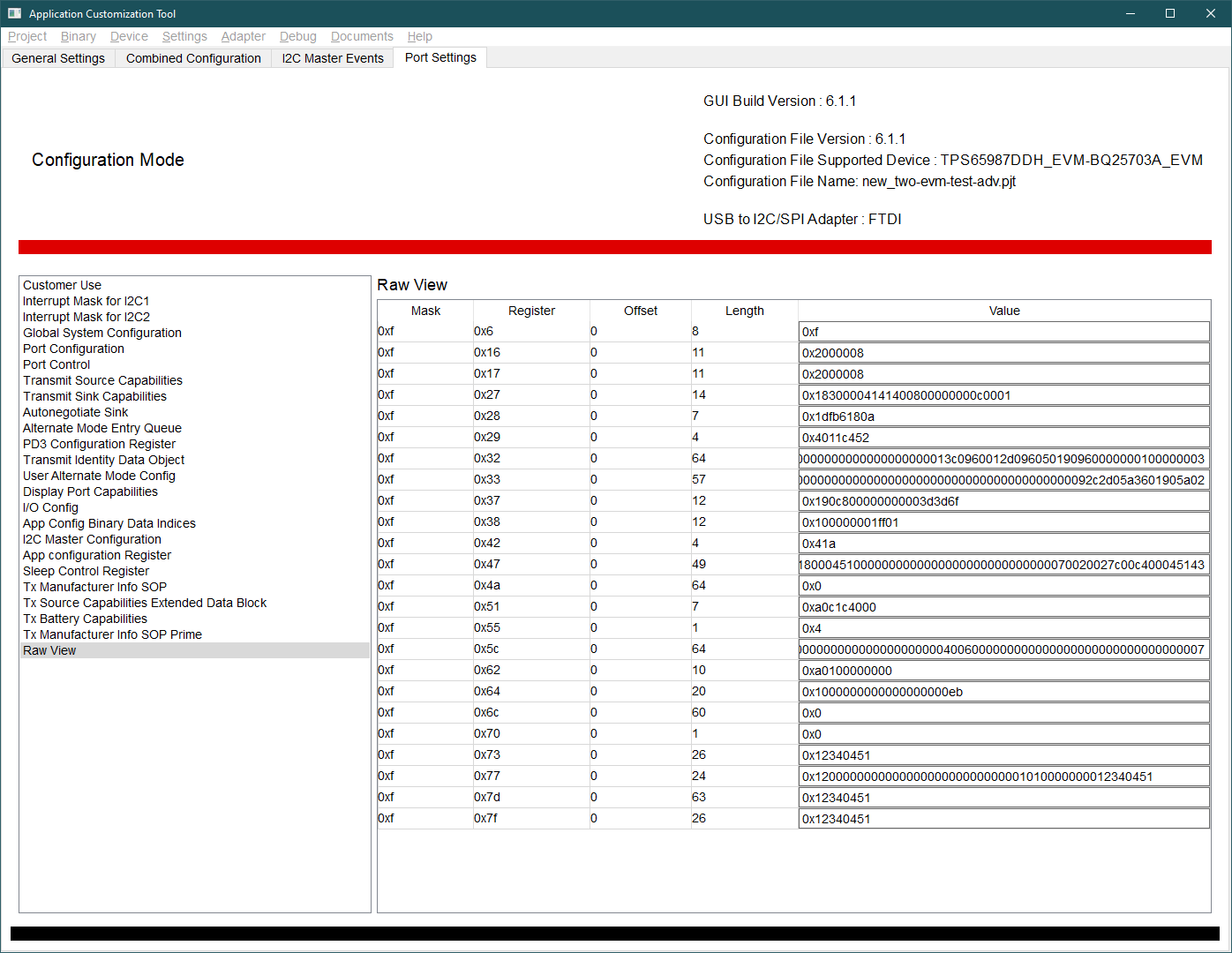

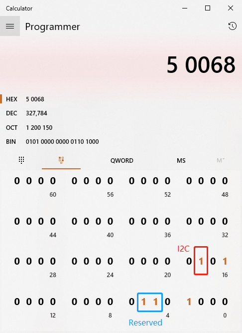

    Since I wired BQ25703A onto I2C3, I have to change I2C master related registers. And I fond something may wrong there.
    1st, after I check the raw view of register 0x5C, I fond that GUI set additional bits that are reserved in the reference manual (P75, 3.36.1 GPIO Multiplexor). Please refer to this picture:
    I am trying to hardwire I2C1 out to test whether I2C3 have some defect...
  • Just follow up. Today, I hardwired I2C1 out and connect it to BQ25703A. Either the project template from you and my project (modified to I2C1) are work fine.
    I am wondering whether my EVM board is broken or GPIO configuration part of the tool has some bug.
    Thanks for your project template.
    I believe this change temporarily solved my problem. However, I still looking forward to seeing the future update of the GUI tool and reference manuals.
