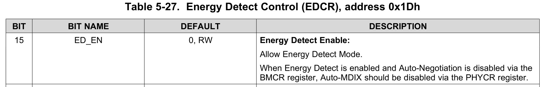

We want to disable the energy detect control in register 0x1Dh, should 0 or 1 be written in bit 15? Because the datasheet doesn't tell clearly.

Energy detect mode is disabled by default, with bit 15 set to 0. If you want to enable energy detect, set bit 15 to 1 and disable auto-neg.
