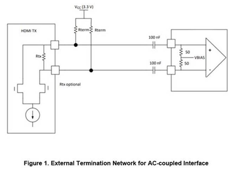

  • I made a mistake in pasting the output circuit.
    We introduced this circuit.
  • Given that FPGA is AC-coupled, I would recommend the customer switch from TMDS181 to DP159.
    The block diagram you showed is for a DC-coupled HDMI connected to a AC-coupled input, which you would then need an external 50ohm termination. It will not work for TMDS181.
    David
  • I may have made a mistake.
    In the customer's case the output of this TMDS181 needs to be AC coupled, does the TMDS181 not work?
    Hiroshi

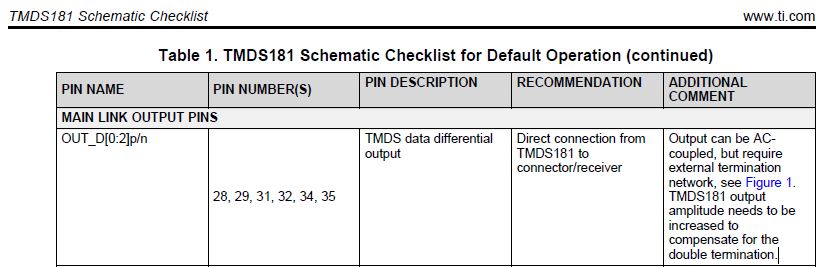

  • Hiroshi-san
    In this case, you need to have external 50ohm termination to 3.3V as shown in the block diagram of your last message and as described in the TMDS181 schematic checklist.
    David
