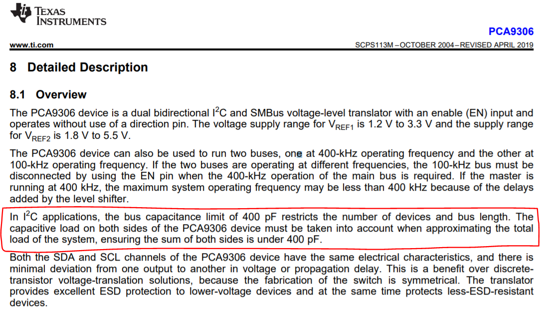

Our customer is evaluating the PCA9306 and having below questions about this part, can you help to answer them? Thanks a lot!
1. In the datasheet overview section, we mentioned the I2C bus capacitance limit of 400pF, but for PCA9306, we can keep this limitation on both side of this device, that means we can isolate the capacitance on I2C bus. Can you help to explain some details reason for this? It will be better that we can provide an internal equivalent circuit.
    This device does not isolate bus capacitance. As stated in the highlighted section, the system designer must ensure the sum of both sides of this device stays under 400pF. The reason for this is due to the pass-FET design of this device. When propagating a LOW signal, PCA9306 effectively connects boths sides together allowing the side that is pulling low to pull the other side low as well. During this time, both sides of the bus are effectively the same and thus the total bus capacitance is the sum of both sides. Let me know if this makes sense or if you'd like further explanation.
