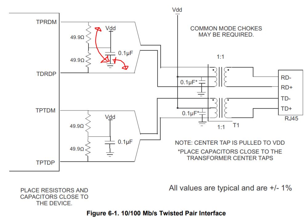

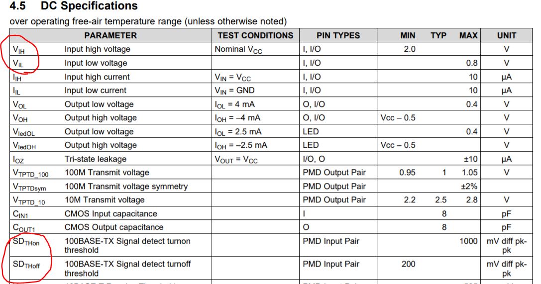

I have a question about DP83849I differential input level.
My customer want to know what voltage is high level/low level input and in the datasheet, there are voltage related with input voltage.
VIH/VIL and SDTHon/SDTHoff.
My understanding is we have to follow VIH/VIL spec but is my understanding correct?
If yes, the VIH/VIL is GND refered voltage?
