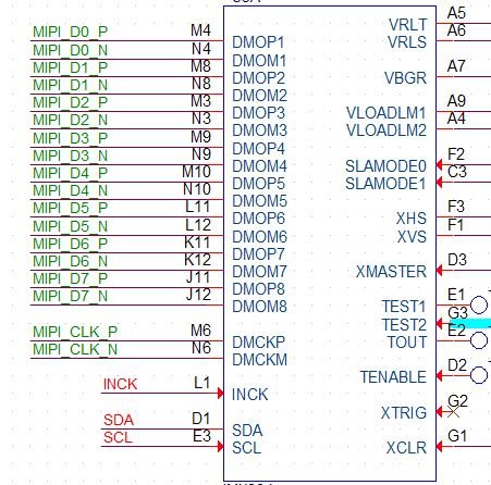

my customer want to use x2 SN65DPHY440SS to bridge 8 lanes MIPI CS-2 interface, they are wondering to know how to connect two SN65DPHY440SS for 8 lanes MIPI CSI-2 interface.

Do you have a block diagram you can share? Are they looking at output 8 lanes simultaneously?

Please refer to below is customer sensor , it's 8-lanes simultaneously output, customer want to use x2 SN65DPHY440SS to extend the distance.
they would like to know how to connect the clock to two re-timer.

The block diagram is missing from your response, would you please attach the block diagram?

Unfortunately, DPHY440 can not support this application.
