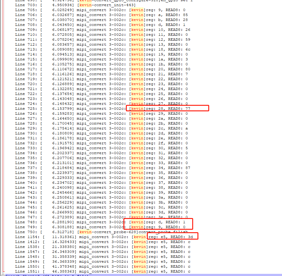

My customer is using SN65DSI84. Below is init write and read register sequence, could help check whether the highlight 3 parts are good?

  • Hi Yang,
    That looks incorrect, especially register 0xE5 which indicates error bits are being set.
    Please have the customer fill out their settings in the DSI-Tuner tool and then attach the .dsi file (press ctrl+e in the tool after filling out the settings to export the .dsi file) to this thread.
