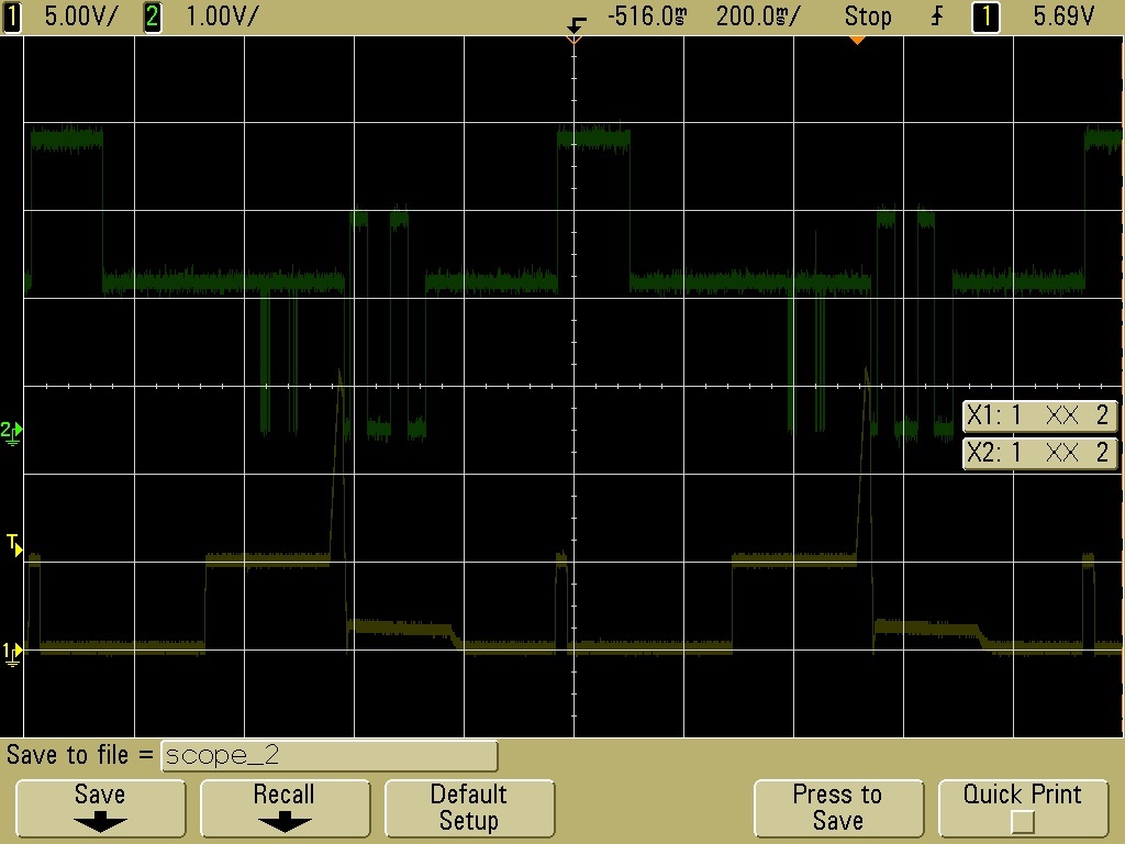

We have designed a charger using TPS65987D,but have the compatibility problems with chrome book.
(1)The negotiation process last for several times, shows in the following picture, Channel 1 = VBUS, Channel 2 = CC line. Seems like something wrong caused CC drop after the voltage trying to rise up.
(2) If we are lucky, with a little chance, the negotiation process succeed.
