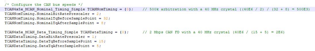

    I want to use the TCAN4550 as the classic CAN transceiver.
    I don't need the CAN FD function.
    Could I get a sample code for the classic CAN using TCAN4550?
    The demo code is test code for the CAN FD.
    If there is no classic code, could you explain how to modify the demo code?
  • Remony,
    There is no separate classic code for the TCAN4550, but changing the current code to work for classic CAN is fairly simple.

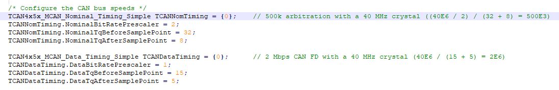

    The changes you'll need to perform are in the main.c project file, within the Init_CAN functon. First, you will need to change the bit rate of the data phase since classic CAN will only work up to 1Mbps:
    The second grouping of code is the data phase bit rate, this will need to be changed to 1Mbps or lower. Refer to the commented formulas to calculate the bit rate using the different parameters.
