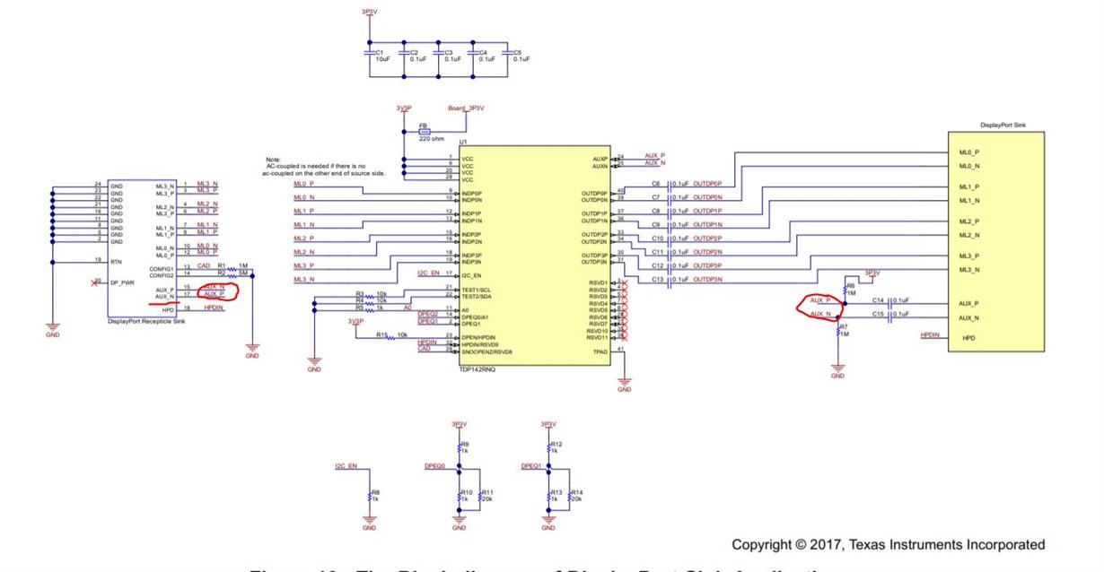

I am reaching out TDP142 SCH connection. In our datasheet, AUX_P/N connection seems like swapped. So why we swap the connection? Thanks!

This is a typo in the datasheet that needs to be fixed.
