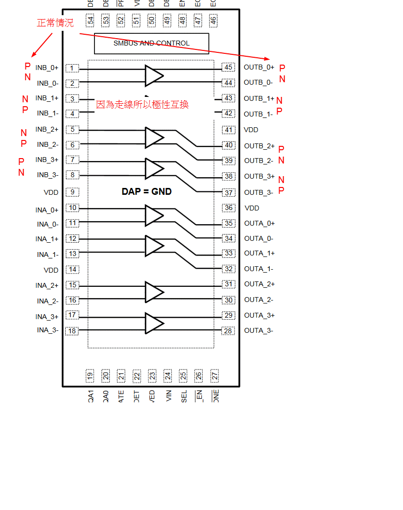

Part Number: DS80PCI800
Because layout issue, may I exchange input and output P/N lines?
Exchange pin 1 and 2, then output pin 45 and 44 exchange as well.
The other input and output pins follow same setting.
Hi Alan,
You can exchange the input and output P/N pins to improve the routing.
