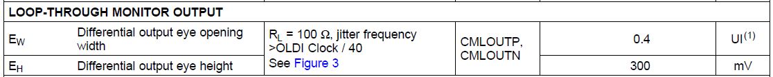

I would like to know the spec of good eye diagram. I use FPD-link III (DS90UH947-Q1 and DS90UH948-Q1).
1. I measure the CMLOUT(after AEQ)  to check if eye diagram match below spec or not. (monitor recovered input of the Deserializer signal)  Is this step, right?
2. Do we need to check signal before AEQ? and Do we have related spec like above image for Deserializer received side. I could measure the RIN0 and RIN1 directly to get eye diagram?
3. If we would like to check eye diagram for back channel signal (948 -> 947), which pin could I measure and do we have related spec for this eye diagram?
4. Which item may we measure to check if FPD link is healthy or not.

  • Hi Roy,
    Each of 947 and 948 has it own specs. There are several way that you can measure the eye diagram.
    1. You can measure the eye diagram from 947 by using the high speed oscilloscope.
    2. You can measure the eye diagram from end-end system by measuring at the CMLOUT after AEQ per your mentioned.
    3. You can use the MAP tool locates in the ALP to monitor the eye opening.
    4. To measure the back channel eye diagram, you need to disconnect serializer side and attach the high speed probe on RINx of the 948.
    Hope this helps. Let me know if you have further questions.
    Aaron
  • Hi Aaron,
      1. Do you mean that I could measure the Rin0 and Rin1 of 948 directly by using high speed oscillator?(measure eye diagram before AEQ)
      2. Could you let me know what is accept Eye Width and Eye Height in this measurement?
      1. Could you tell me what is the acceptable eye diagram by measuring at the CMLOUT? (image that I attached previous page?)
      1. I use the ALP and refer to SNLA301, if I could match fig.6 in SNLA30, we could say that is acceptable eye diagram?
      1. Could you let me know what is accept Eye Width and Eye Height in this measurement?
    Thank you.
    Roy

  • Hi Roy,
    I reviewed the datasheet for both 947 and 948. I do not see eye height and width specification.
    1. I meant you can measure the eye diagram from 947 -> oscilloscope not through 948.
    2. You can also measure the eye diagram from the CMLOUT after AEQ. I would recommend to use the MAP tool to analyze and understand the signal integrity. This is very similar to CMLOUT. There is no mathematical represent to the MAP tool. Basically, if you see the larger green area representing in digital, this indicates the larger eye.
    3. Every device is different. I wouldn't recommend to use the figure 6 as your reference.
    4. Again, I do not have the eye height and width.
    Aaron

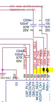

  • Hi Aaron,
    I still have some question about measuring eye diagram before AEQ.
    Do you mean that I could measure the Rin0 and Rin1 of 948 directly by using high speed oscillator?(measure eye diagram before AEQ) Could you let me know what is accept Eye Width and Eye Height in this measurement?
    I will have no idea which point should I measure if I would like to get eye diagram before AEQ. Is below test point correct?
    Do we need to measure this point? or just need to measure CMLout to check if FPD-link is healthy or not?
    Roy
  • Hi Roy,
    Sorry for the confusion. If you measure the eye before 947, this eye will be without AEQ, which mean the 948 is not connected to 947. If you want to measure the eye with AEQ, then you need to measure at the CMLOUT or use the MAP tool embedded in the ALP sofware. The MAP tool is the best method for you to analyze the signal integrity.
    My suggestion is to connect 947 to 948, and use the MAP tool. The app note that you showed me last time should be able to guide you obtaining the eye.
    Hope this helps.
    Aaron
  • Hi Aaron.
    I think that I got your point.
    We should concern CMLOUT's eye diagram because it's the real data in 948.
    I asked measuring the 948 Rin side because customer would like to check if their cable use is good or not. So they didn't want to measure the eye diagram after AEQ.
    Roy
  • Hi Roy,
    If you want to make sure the cables is met the specs for your application, you need to measure the return and insertion loss of the cables. The parameters will determine if it will falls in the channel specs of the 948 as well as a whole system such as 947, interconnect, connectors, and 948.
    Aaron
