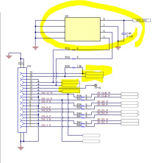

Hi Team,
I would like to know the J18 function in yellow circle in DS90UB949-Q1EVM APP note.(http://www.ti.com/lit/ug/snlu232a/snlu232a.pdf?ts=1588061193805)
Roy
  • Hi Roy,

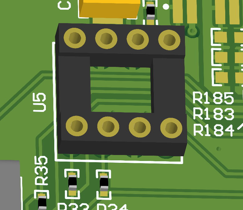

    U5 is a DIP socket for placing an external local EEPROM for EDID, which is accessed via the DDC interface.  Pin 8 on the socket U5 is powered by VDD_DDC.

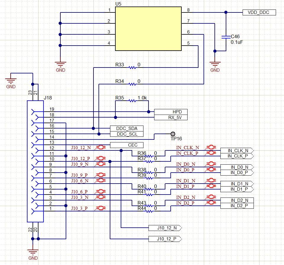

    For J18:
    19: HPD
    18: RX_5V
    16: DDC_SDA
    15: DDC_SCL
    13: CEC
    I have included images below.
