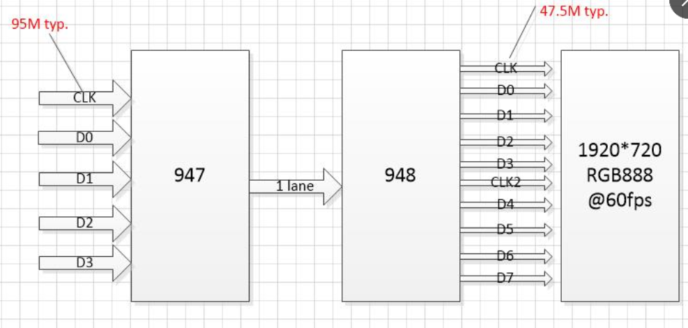

Hi Team,
My customer now would like to evaluate 947+948 application.

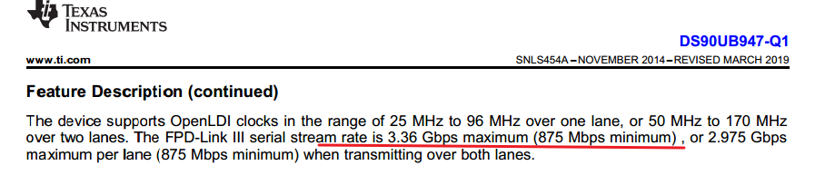

In 948:1920*720*60*35bit*1.05=3.045G
In 947: single lane could support 3.36G.
So I think this application is suitable, right?

Hello Amelie,
Yes, for single link 947->948 can support 96MHz PCLK. The PCLK required for the above example is 1920x720x60x1.05 = 87MHz so it would be supported.
