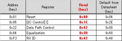

Hi all,
I have a question about DS90UB926Q-Q1.
The customer has read the default register.
As a result, the default values differed from datasheet.
The result of the register different from the default is shown below.
Results read in red.
Is the data sheet different?
Please check.
Ishiwata
  • Hi Ishiwata,
    The register 0x22 is loaded from the serialzier so if there is a serializer connected, the value will change.
    Register 0xF2 =0x42 is correct since this is a UB device.  0x42 matches the letter B.
    I will look into the rest.

  • Hi Ishiwata,
    For register 0x05, 0x1E is the correct value,
    For register 0x44, this register is for adaptive EQ and will change depends on the EQ setting.
    For register 0x01, the default should be 0x04 instead of 0x0.
    Would the customer be able to try doing a digital reset including registers to see if 0x1 returns to 0x04?

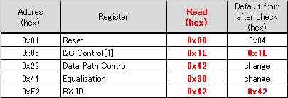

  • Hi Charley,
    Thank you for your reply.
    Register 0x01 prompts the customer again for confirmation.
    The check results are summarized below. Is it OK?
    Although there was no description about the confirmation of the top marking, does it mean that there was no particular abnormality?
    Ishiwata
  • Hi Ishiwata,
    Yes, we need some confirmation from the customer about register 0x01.
    The summarized results are ok.

  • Hi Charley,
    Customer tried that turned on / off the power and confirmed Reset [0x01].
    Also performed a digital reset. The result was 0x00.
    Do you have Possible causes?
    Ishiwata
  • Hi Ishiwata,
    I was not able to find any clue on why this register is different. We were able to check some 926 devices we have here and the register read matches datasheet.
    Do they see this on multiple devices or just a single device?
    The customer can send this device back to TI for verification.
    On a functional level, this register can be overwritten to desired setting after device power on.
    Charley Cai

  • Hi Ishiwata,
    >Currently, if the register of 0x00 is 0x00, Back Channel is disabled, so it is not locked and does not operate normally.
    >However, because it is operating as a reality, Back Channel is operating.
    The 0x01[2] register in 926 should control the I2C communication from 926 to 925 when the I2C master is on the 926 side. There is no impact to other back channel operations.
    If the I2C master is at the 925 side, there's no impact on device operation.
    If the customer wish to have a I2C master at 926 side communicating to 925, they could turn on the 0x01[2].
