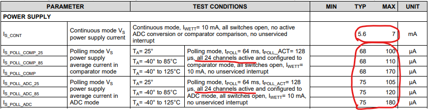

I have one question from customer about TIC12400-Q1 supply current in continuous mode and polling mode.
In datasheet EC table, the current is under all 24 channels active condition. How about the typical and maximum current if we only enable 12 channels in 1Bh IN_EN register?
Thanks.
