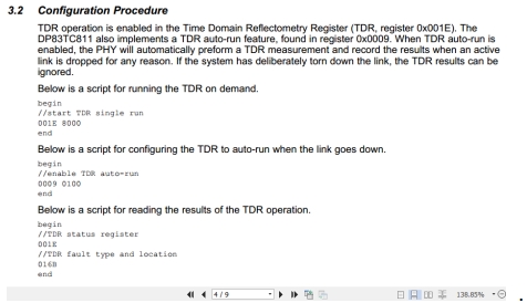

    Have you reviewed our application note that outlines the registers to configure TDR? Section 3 of this document should help you. Please let me know if you are still unable to configure properly after reviewing the document.
    http://www.ti.com/lit/an/snla291/snla291.pdf

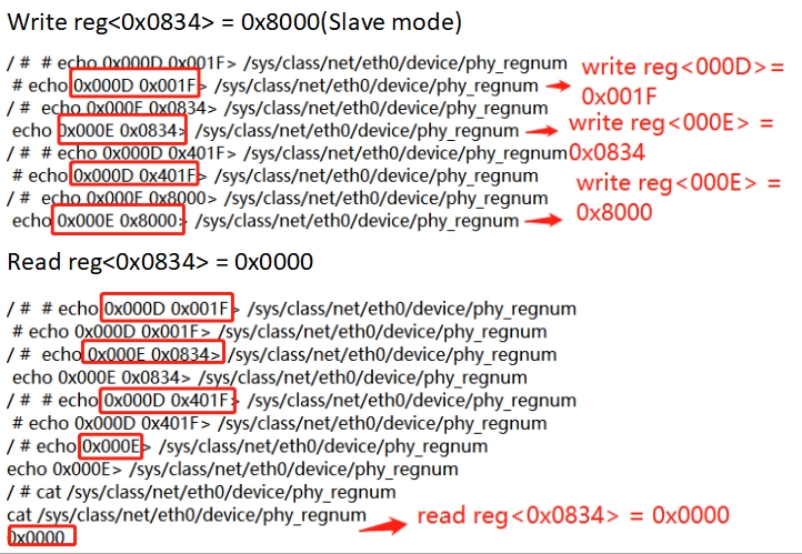

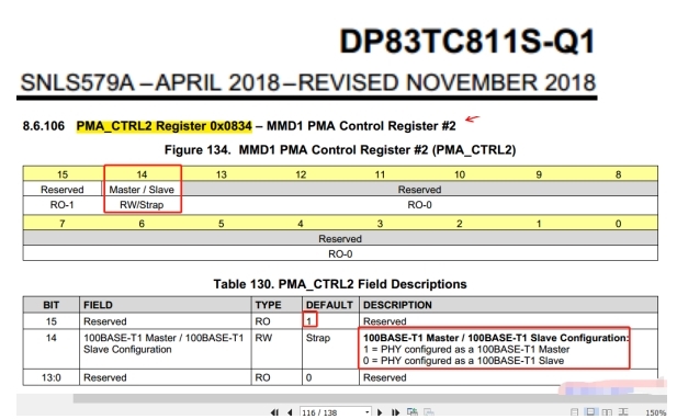

    STEP1: The 1st requirement is changing the Master mode to Slave, and changing the slave mode to master freely.
    According to file of DP83TC811,which is screenshoted below,if the PMA_CTRL Register(0x0834) of the phy is wrriten to 0xC000, The phy should be a MASTER mode. If the same register is wrriten to 0x8000, the phy should be a SLAVE mode.
    Test result: The real test result is that the phy gets 0x0000 all the time,however, the mode can NOT be changed at all.

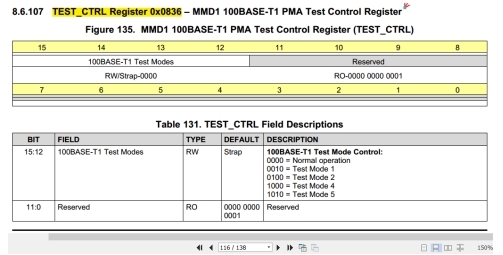

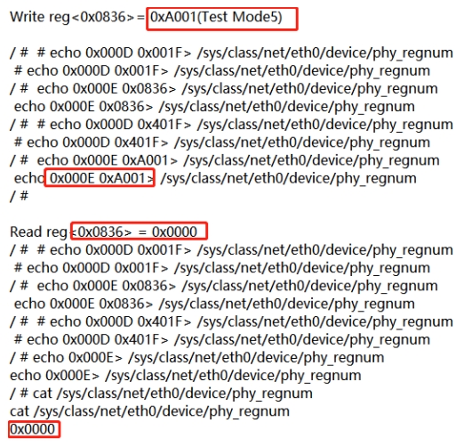

     Step 2: The 2nd requirement is entering and exiting the test mode.
    According to file,which is mentioned above,if the TEST_CTRL_Register(0x0836) is wrriten to 0x2001, 0x4001,0x8001 or 0xA001; the phy will enter Test Mode 1,Test Mode 2,Test Mode 4 or Test Mode 5.
    Test Result: The real test result is that the phy gets 0x0000 all the time,however, the test mode can NOT be changed at all

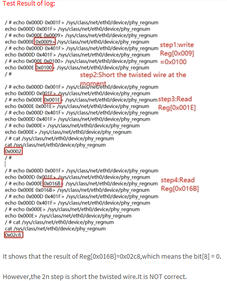

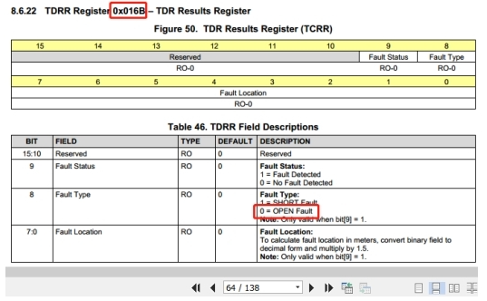

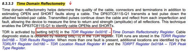

    STEP 3: The 3rd requirement is about TDR.
    According to file named snla291.pdf,whose internet connection is show below, we will get TDR result after several operation steps .

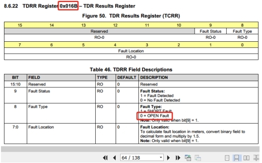

    Test Result of log:
    It shows that the result of Reg[0x016B]=0x02c8,which means the bit[8] = 0.
    However,the 2n step is short the twisted wire.It is NOT correct.

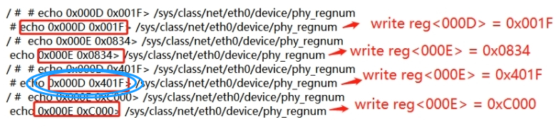

    / # echo 0x000D 0x001F> /sys/class/net/eth0/device/phy_regnum
    / # echo 0x000E 0x0834> /sys/class/net/eth0/device/phy_regnum
    / # echo 0x000D 0x401F> /sys/class/net/eth0/device/phy_regnum
    / # echo 0x000E> /sys/class/net/eth0/device/phy_regnum
    / # cat /sys/class/net/eth0/device/phy_regnum
    0x0000
    Also, in your steps you have written down did you mean to say write reg <000D> = 0x401F and NOT write reg <000E> = 0x401F
    Because you will need to write 0x401F to register 0xD NOT 0xE.
    Sorry,my comment on the picture is wrong,however, I did write reg <000D> = 0x401F,which is highlight by 2 blue ovals.
    If the board is also strapped to either master or slave mode you can read these values on Reg 0x467 as well
    < read the values on Reg 0x467 = 0x0000 >

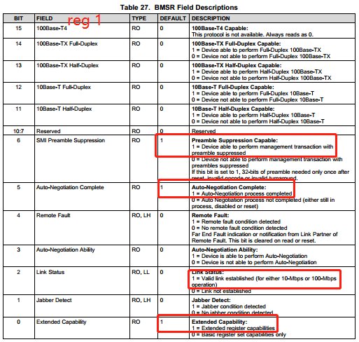

          Thanks for for advices.Here are the logs of reg<0x0>,reg<0x1> and reg<0x0198>:
    (Read reg<0x0000>= 0x2100)
    / # echo 0x000E 0x0000> /sys/class/net/eth0/device/phy_regnum
    0x2100
    According to the file  SNLS579A –APRIL 2018–REVISED NOVEMBER 2018 .pdf,
    The result is correct.
    (Read reg<0x0001>= 0x0065)
    / # echo 0x000E 0x0001> /sys/class/net/eth0/device/phy_regnum
    0x0065

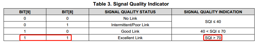

    (Read reg<0x0198>= 0x034b)
    / # echo 0x000E 0x0198> /sys/class/net/eth0/device/phy_regnum
    0x034b
    reg<0x0198>= 0x034b means the bit[9]=0x1, bit[8]=0x1, and the SQI = 0x4b(75 in decimal).
    The result is perfect!

  • Hello Button,
    It looks like for the extended registers you are writing 401F however, register 0x834 is in MMD1 Field and you will need to write 4001 NOT 401F
    Cecilia
  • Hi Cecilia,
           Here are the new logs about reading reg<0x0834>=0x0000,
    which are the same as before. And the debug result is NOT what we want.
    (Read reg<0x0834>=0x0000)
    / # echo 0x000D 0x001F> /sys/class/net/eth0/device/phy_regnum            (Write reg<0x000D>=0x001F)
    / # echo 0x000E 0x0834> /sys/class/net/eth0/device/phy_regnum             (Write reg<0x000E>=0x0834)
    / # echo 0x000D 0x4001> /sys/class/net/eth0/device/phy_regnum             (Write reg<0x000D>=0x4001)
    echo 0x000E> /sys/class/net/eth0/device/phy_regnum                                (Read reg<0x0834>)
    0x0000                                                                                                           (Show the value of reg<0x0834>)
    I'm puzzled that :
         Wether my operration is OK or not okay?
  • Please refer to Table 24 of the datasheet for an example.
    To access MMD1 registers you will need to write 0x1 to reg 0xD. I believe in the example above you have written 1F to 0xD whcih continues to write in the MMD1F field
    Please let me know if that works.
  • Hi Cecilia,
    Here are some issues about TDR:
    Even though I use the similar operation as below, it is not OK all the same.
    / # echo 0x000E 0x0009> /sys/class/net/eth0/device/phy_regnum
    / # echo 0x000E 0x0100> /sys/class/net/eth0/device/phy_regnum
    / # echo 0x000D 0x0001> /sys/class/net/eth0/device/phy_regnum
    / # echo 0x000E 0x001E> /sys/class/net/eth0/device/phy_regnum
    0x0002  (the result  was 0x0000 sometimes)
    / # echo 0x000E 0x016B> /sys/class/net/eth0/device/phy_regnum
    0x02c8   (usually, the result was 0x0000)
    My topic is that: what should I do so that I can get the correct TDR result.

    Acording to the the file named snla291.pdf, Writing<0x0009> = 0x0100 to ENABLE TDR auto-run
    After getting the result of OPEN/SHORT ,even though,  Writing<0x0009> = 0x0000 to DISABLE  TDR auto-run,
    which  did NOT work ,too.
