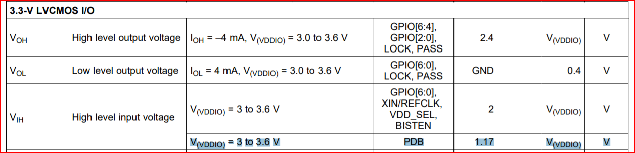

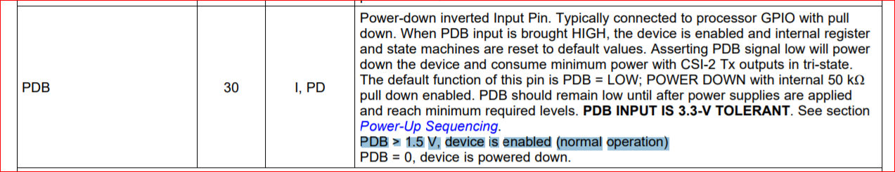

Could you please help to check the PDB enable voltage threshold, >1.17V or need to >5V?

Hello Fery,
We will need a couple days to check back on the characterization data for this. Thanks for pointing out this issue in the documentation
