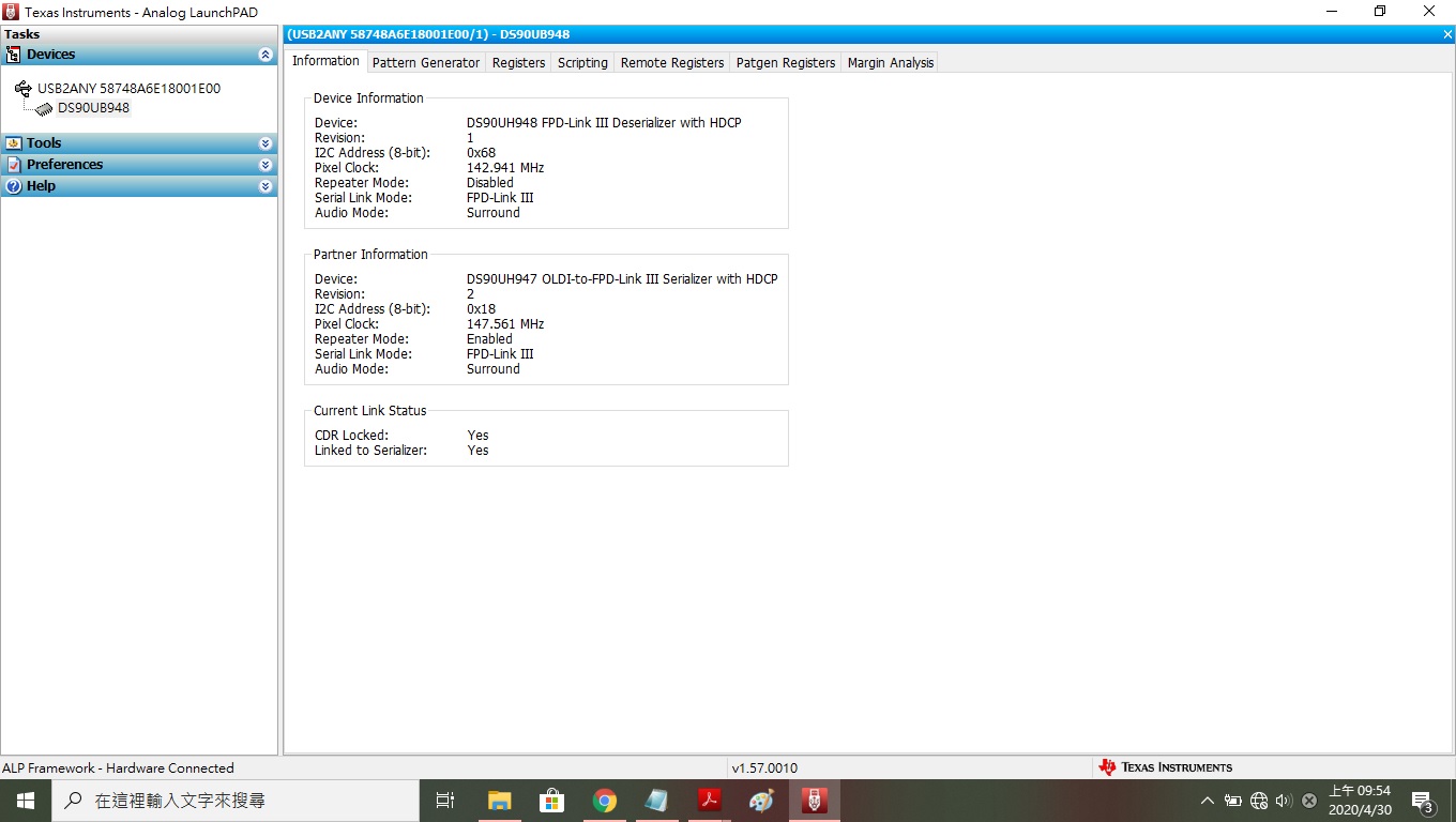

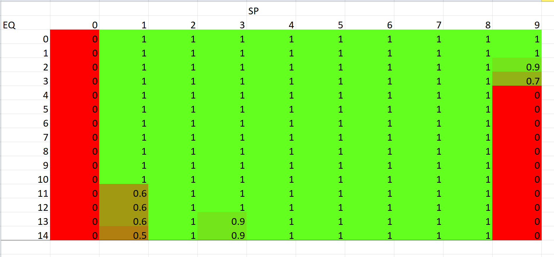

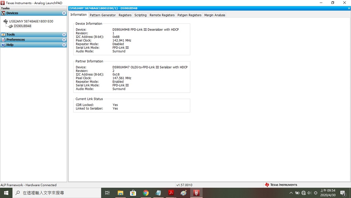

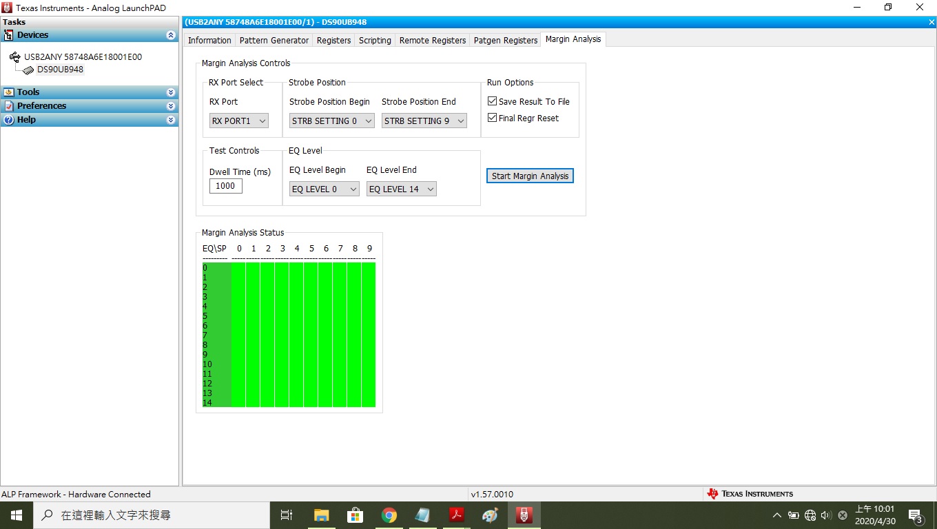

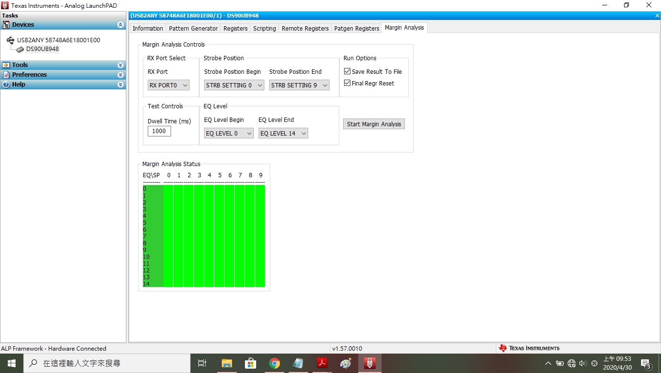

Hi Team,
I use ALP to measure MAP and the test result is showing all color is green (EQ:0-14 SP:0-9)
Is that make sense? (I also disconnect the 947 and it shows all color is red.)
And in SNLA301, it said that when EQ(9;10) and SP(5;6;7;8) is green and that is recommended margin. Is it appropriate to DS90UB948-Q1?
