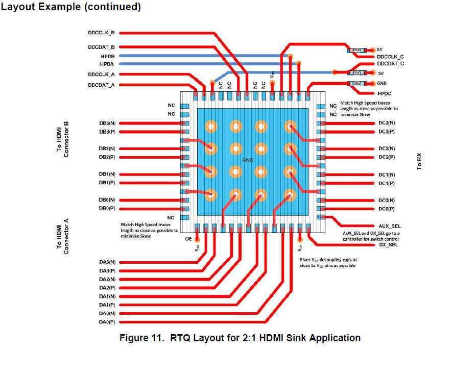

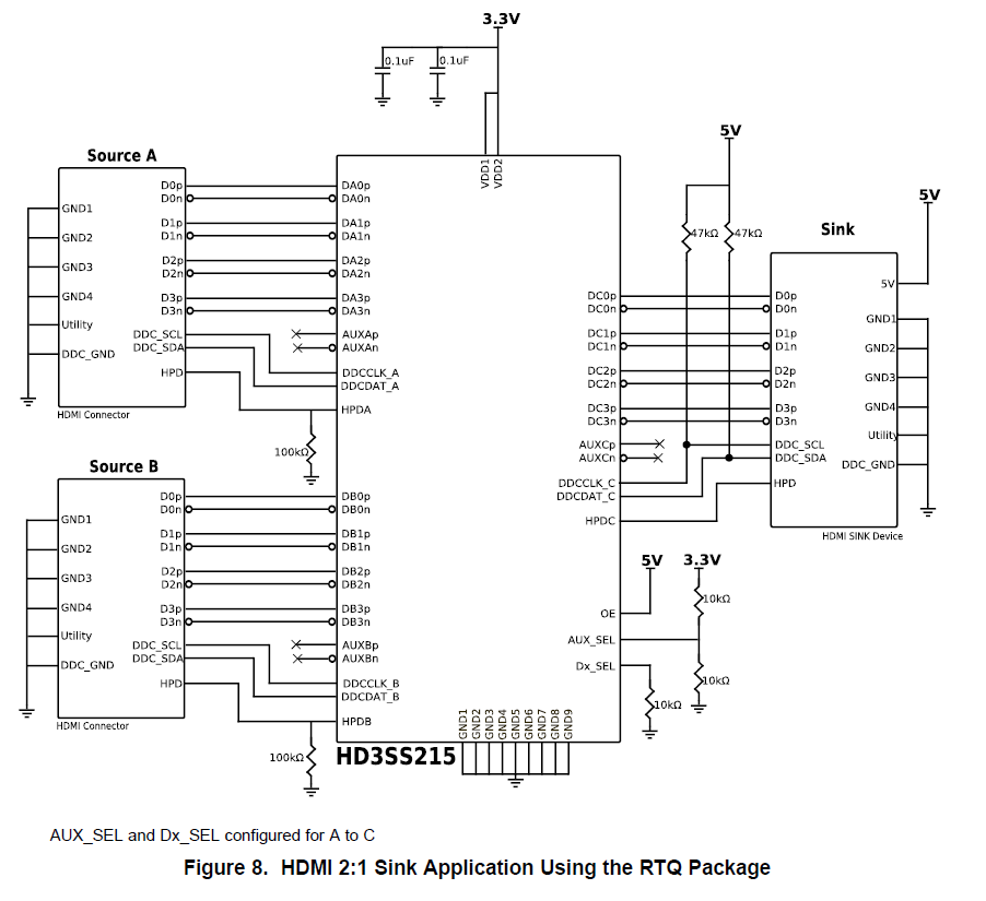

I am designing a HDMI switch Board, using HD3SS215 IC
but I faced a problem while routing the PCB, following the datasheet, the pins of IC must be directly connected to HDMI connector without Vias to avoid noise
but I found that I will need a lot of vias in my design and I don't know the reason, I followed the schematic shown in the datasheet
I tried many other ICs and Connector but the same
so anyone can help me ?
please kindly check the attached photos, I will find screenshots from datasheet and from my design
