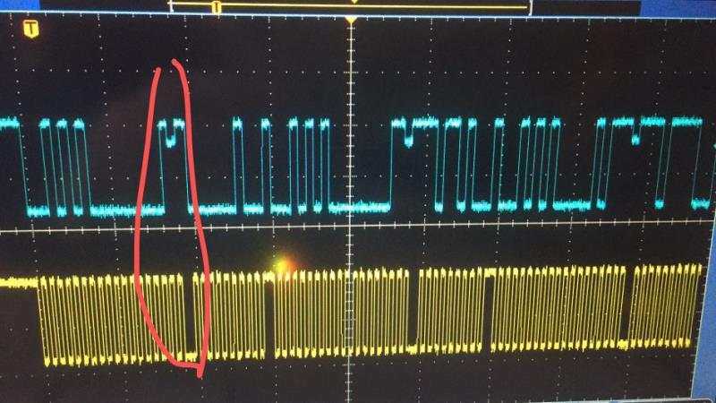

MCU read/write the cby I2C。 by I2C address,reg,data have ack .But just the reg ack logic low is not to 0V The Vdd is =3.3V

Hi Lei Wang,
If the microcontroller in the above image is the master and the DS90UB925 is trying to ACK, please ensure that the I2C pins on the microcontroller are not set to push-pull outputs, but instead are configured as open-drain outputs.
If this doesn't resolve the issue, please share more information such as pull up resistance, bus capacitance, number of devices on the i2c bus and i2c data rate.
