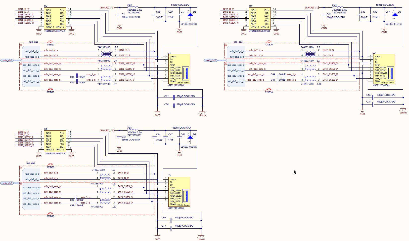

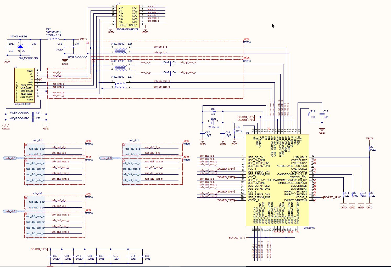

    Our USB hub PCA (based on TUSB8041) contains no EEPROM, neither can it be configured through SMBbus  by use of a microcontroller (because the PCB contains no microcontroller only the TUSB8041 hub controller). So for configuration we are dependent on the default pullup and pull down's on the PCB and in TUSB8041. In the pictures below you can find the downstream port connections, upstream port connections and TUSB8041 controller. From this picture you can see that there is no EEPROM neither is SMBBUS configured.
    Because there is no EEPROM or SMBBUS we can not configure DSPORT_ECRT bit as requested in your reply. So according to the datasheet the value of DSPORT_ECR will be the default value at power up which is 0. What does this bit do and what happens if bit is 0 in stead of 1 (as requested in your reply)?
    Fullpwrmgmtz is configured during reset and since pin 40 of TUSB8041 is unconnected in schematics fullpwrmgmtz will be set to 0 during power up (because according to the datasheet pin 40 has a internal pull down). Note also that datasheets state that pin FULLPWRMGMTZ can be left unconnected if full power management and SMBUS are not implemented. For this reason we have left pin 40 unconnected.

    I have been able to reproduce the issues also under Ubuntu 20  operating system. Fortunately with Linux it is easier to collect kernel logging. I have attached a file where you see typical error messages when we disconnect and reconnect USB cable to host computer.  Unfortunately we could not try your suggestion trying to pull pin 40 (fullpwrmgmtz) high, because we did not succeed attaching a wire to pin 40. So we need to change the board layout and replace TTUSB8041 with TUSB8041A.  Before we do this I need confirmation from you that following your suggestions will solve the issues we have observed.
    So my question to you is:
    1. Do you think that when we migrate to TUSB8041A and pull pin FULLPWRMGMTZ high will resolve the issues when we disconnect and reconnec the USB cable?
    2. Our USB hub is self powered. We currently have powered the downstream ports from the local 5V power supply (i.e. downstream VBUS connection is connected to local 5V power supply). Can this also cause problems? If it causes problems, do we need to interrupt the downstream VBUS connection if the upstream VBUS connection is lost (i.e. if upstream VBUS=0 then disconnect local 5V power supply from all downstream VBUS connections).
    3. Do you have other recommendations we should incorporate in next board design/layout in order to fix the observed issues?
