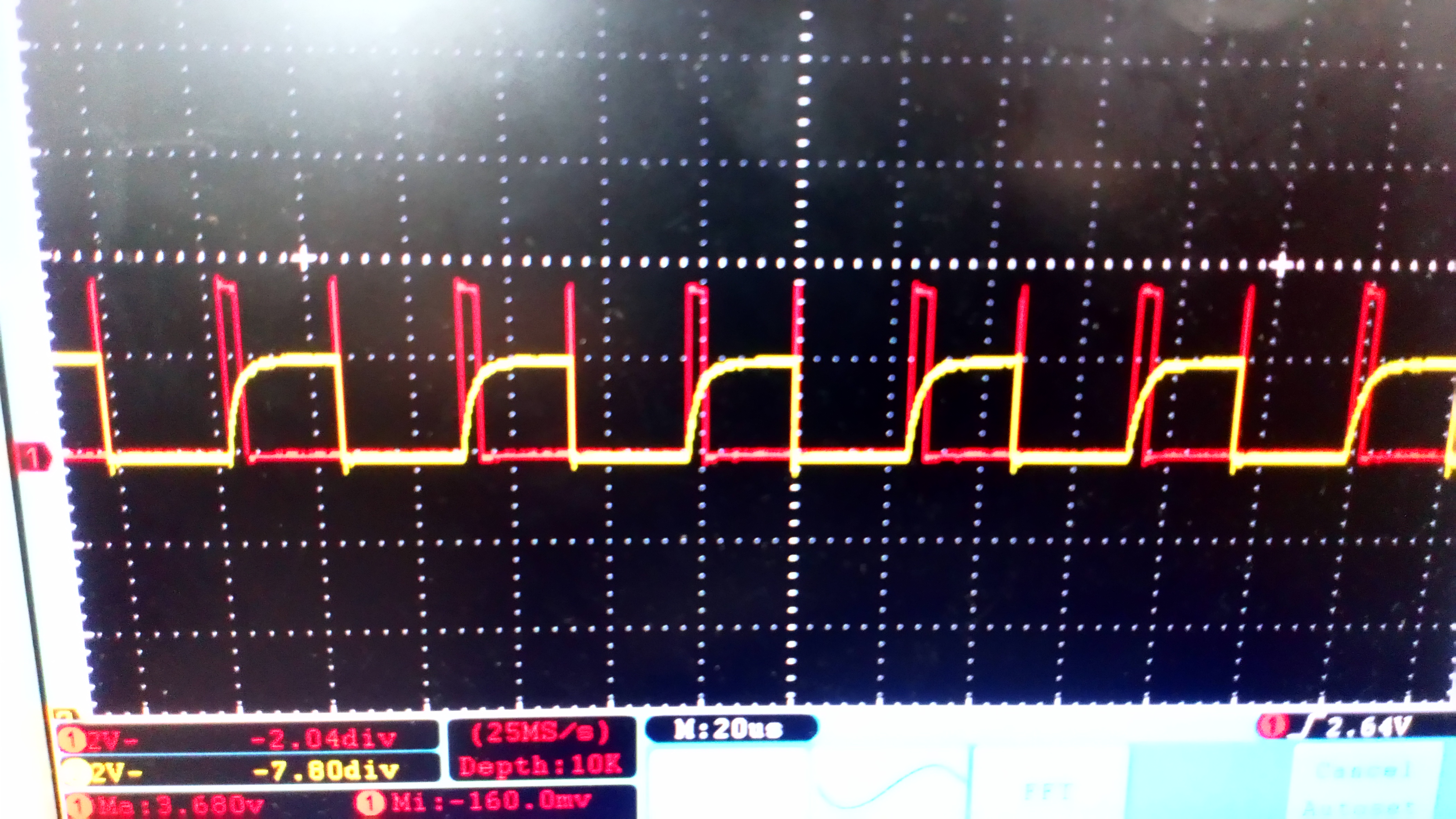

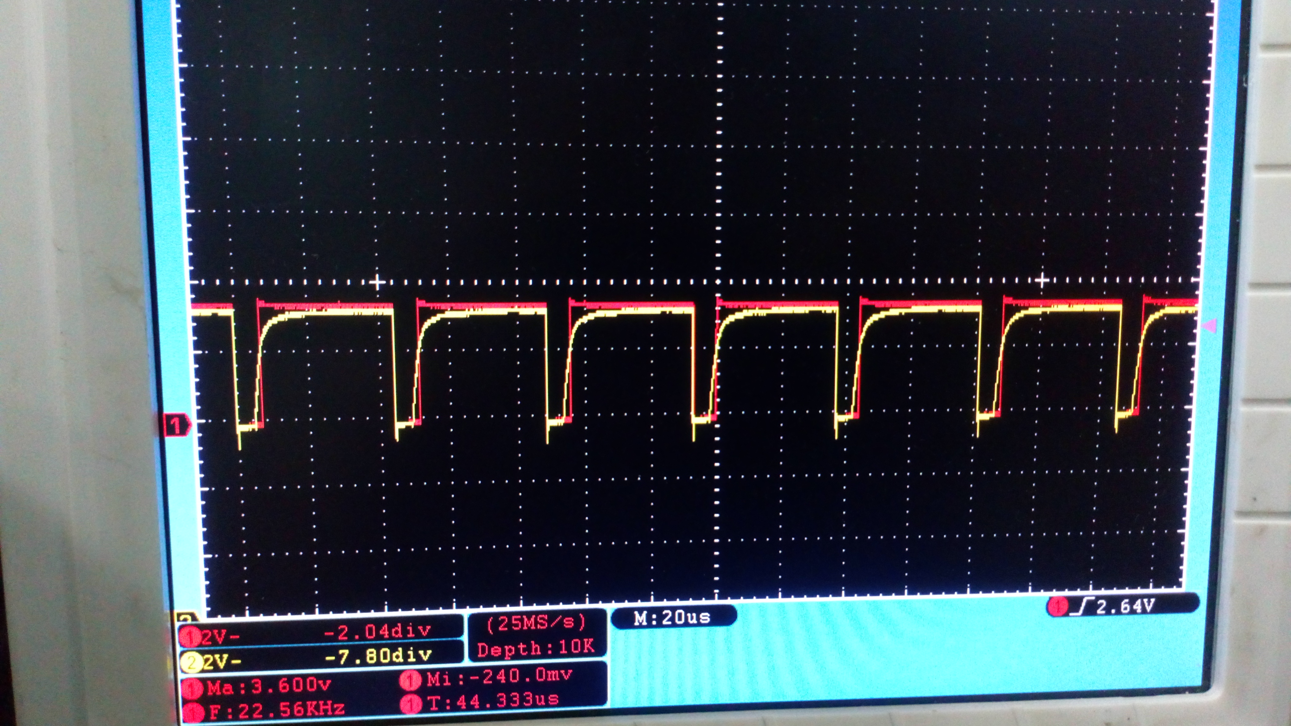

We are developing new product based on SN65HVD96 and Power over data application note http://www.ti.com/lit/an/slla336/slla336.pdf?&ts=1588921006385 and it's not working.
We have based our design in the one in Figure5.
We have two testing boards (Find schematic attached):
- We are injecting square wave on D pin of the first one to simulate transmission frame.
- On second board we are receiving wavecorrectly until R pin is reached, there wave is lost.
We have tried to using 120 ohm resistor as described in Figure5, but not working too.
If we use asymmetric wave it works fine.
We have tested with square wave frecuency range between 4 - 30KHz
