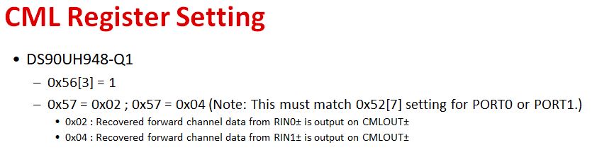

I would like to use CML output to verify my the FPD-link healthy. Below is my question and setting.
Roy
  • Hi Roy,
    1. The register setting is correct.
    2. You only need to supply the target PCLK frequency. 947 will generate data at the target frequency once you supply the PCLK.
    3.1. Yes.  3.2, the 360mV is peak to peak.
    Charley Cai

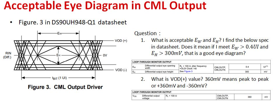

     Based on your comments, I still have some questions showing as below
    1. no question.
    2. Does CML out is only test data from 947? I mean that if I connect to real LVDS signal into 947 and then CML output is the real data that I send from 947?
    3.1 no question.

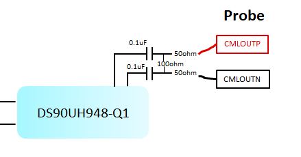

    3.2 If the 360mV is the peak to peak which means +/-180mV, my test result seem to weird. You could see the peak value is over 200mV, and the EH spec(+/-150mV) is difficult to achieve.
    Could you give me some comments for this result?
    attach the measurement
    Roy
  • Hi Roy,
    2. The FPD-Link channel will always be running regardless of actual data is sent or not. If no data is sent, we will just stuff dummy data into the channel. The CMLOUT will just output the dummy data. If actual data is sent, CMLOUT will just be the actual data. Note that they will be encoded so you really cannot tell the difference. The CMLOUT will be applicable for both cases.
    3.2 The 360mV is just a typical value. Your eye diagram looks fine.
    Are you using a differential probe?
    Charley Cai
  • Hi Charley,
    2.    Got it. Thank you for your comments.
    3.2  Do you mean EH is the approximate value and couldn't need in interval [-180mV/180mV]? Does EH have maximum value and minimum value? And Does EW need to follow > 0.4UI?
    Are you using a differential probe? Yes
    Roy
  • Hi Roy,
    3.2 The datasheet only lists typical spec for both the EH and EW.
    In additional to CMLOUT measurements, you can use MAP tool for channel quality as well.
    Charley Cai
