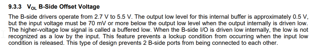

Dear,
Per you datasheet, it seem two B-side port can't connect in serial.

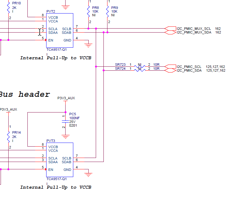

However our application are connect in parallel, we want to confirm can you use TCA9517-Q1 in example circuit(parallel) below.
This example connect two TCA9517-Q1 B side port to the same host.
Is it OK?
And how about paralle three TCA9517-Q1 and connect to the same I2C master??
