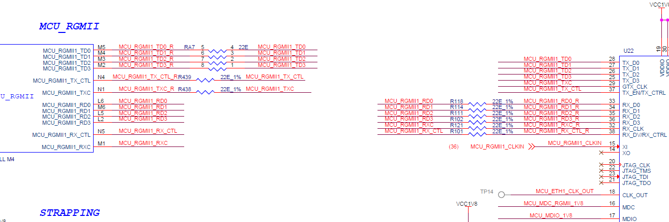

The datasheet for the DP83867IS says there are internal termination resistors for the transmission lines...
Some reference designs for the DP83867IR show 0Ω resistors on the transmission lines, because of this.
http://www.ti.com/tool/TIDA-010010
http://www.ti.com/tool/TIDA-00204
However, in the TMDX654GPEVM, the PHY has 22Ω termination resistors on Tx/Rx lines...(see below image)
http://www.ti.com/tool/TMDX654GPEVM
What happens if termination resistance is used? Could this cause issues somehow with the internal termination? Is there a reason why you would still want external termination?
